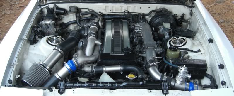

Here's where I drilled the hole for my harness:
Look at the firewall below the speedo cable hole, there is a hardline running along near the top of the transmission tunnel. There is a clip for the hardline bolted into the firewall just above an open space. I drilled my hole on center just below the bolt at this point. I recommend going with a 2.5" hole saw. Drill right there and at most you'll hit the corner of a plastic bracket.
Using this method I was able to mount the ECU in the "stock location" although it faces the other direction and you'll have to get creative with the mounts it works. You still have to extend 18-30 body harness wires, depending on options.
