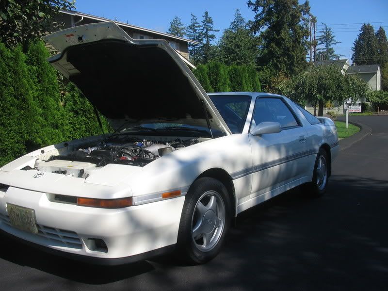

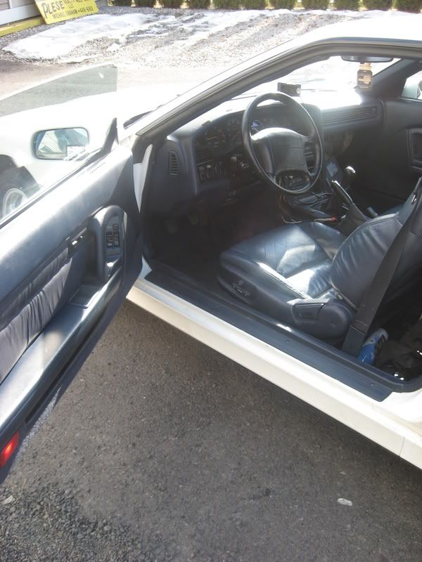

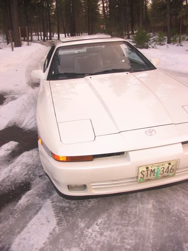

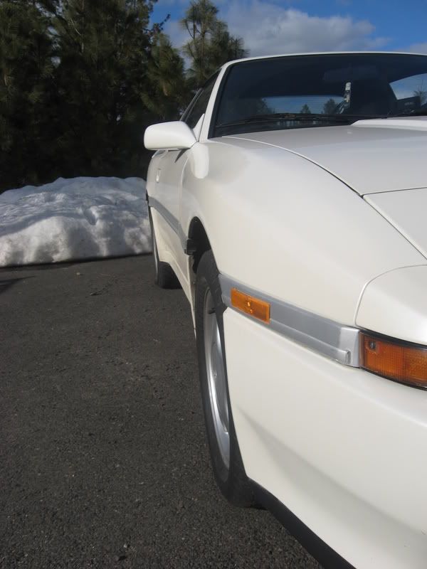

So my project starts now! I have a White 91, turbo, sunroof, 5speed.
But before, here are some pictures of my car!
Go to page 2 and 3 for major updates!!!
[before]

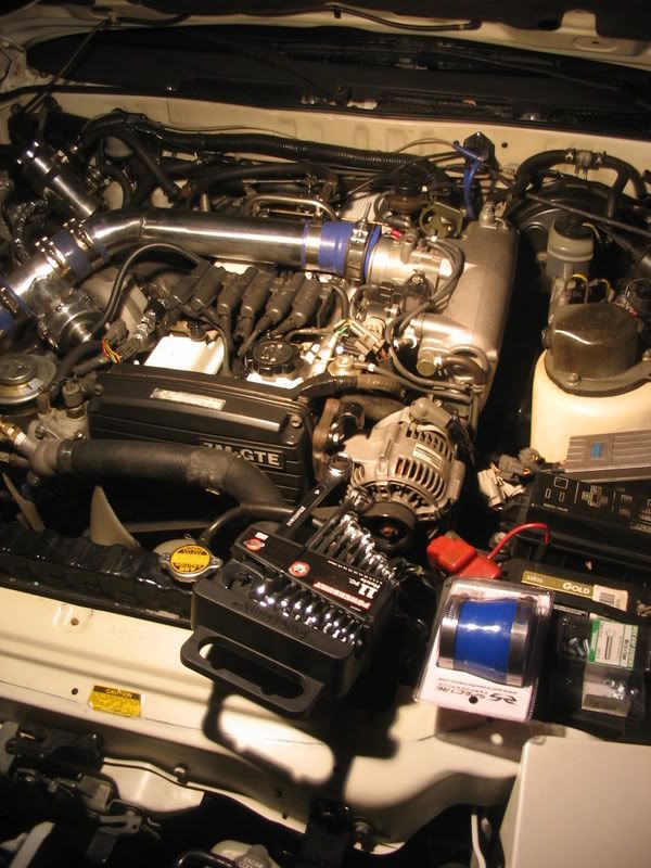

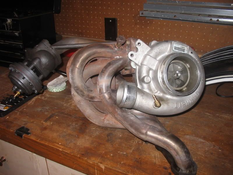

Some parts came in! Check it out!
Autometer cf gauge(boost I belive), and my AEM wideband.
My new clutch, fuel pump.
garret gt4088

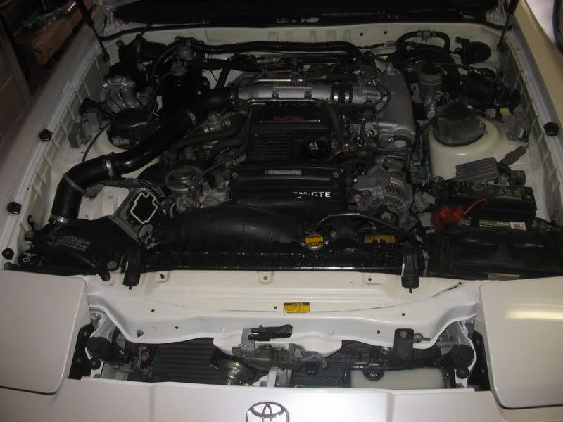

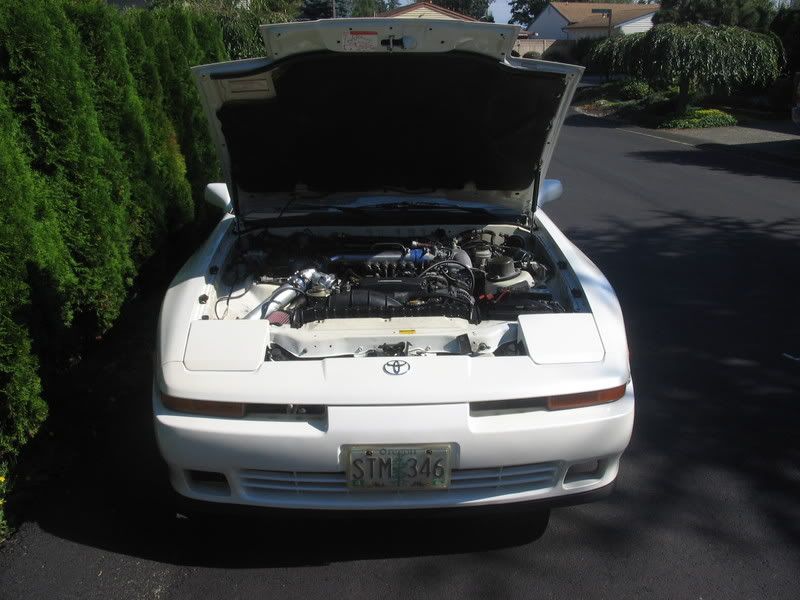

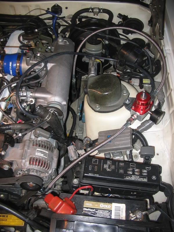

Sep 19 update!

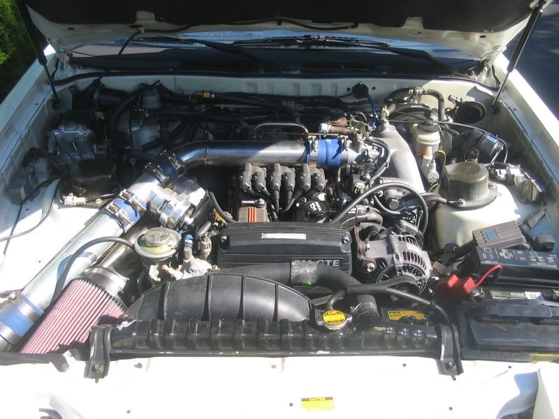

I just finished getting it up and running, ya their is some ghetto ass plumbing going on but after 16 hours of straight work all we wanted was for it to run! Anyways Ill fix that soon.
anyways heres some pictures:
[After]
K, well its allmost their Just got to install a few other things!
Ps: Kevin if your reading this thanks for all the help!
Allright well thats all for now.

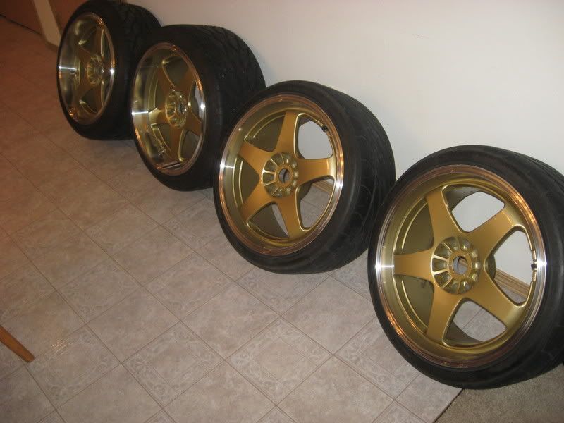

Update march 28th

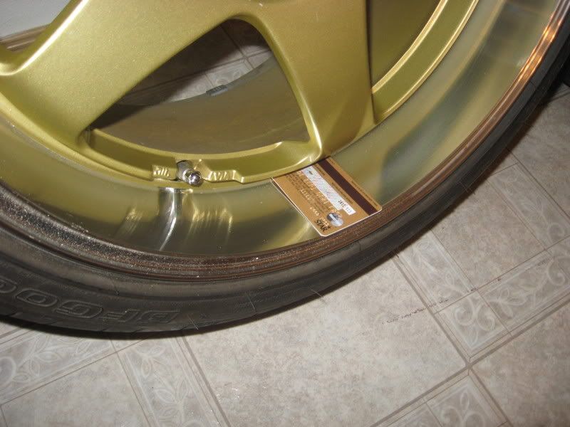

Sportmax 962's
Also after a lot of thinking... I am having the Gt4088 rebuilt and then I am selling it. I'm going to go with the 60-1 from Drifmotion and also going Maft Pro. Thats so far whats going on. Me and justin are going to L.E.D my climate control when I get my car back.

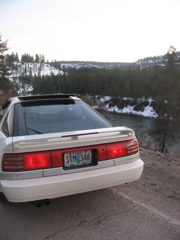

Hahaha I knew somewon would bring that up! They are replica regulus tail light covers that Kevin got made. This isnt my house its at a buddy's house its "KevinM" house. He also made the sunshades and the turn sighnal covers.
