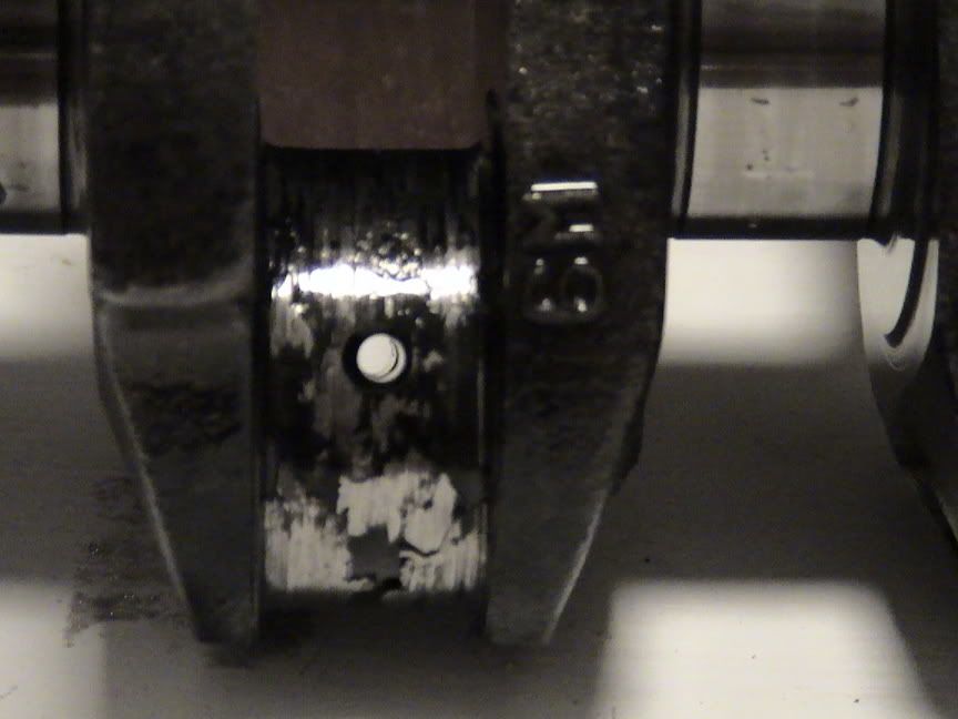

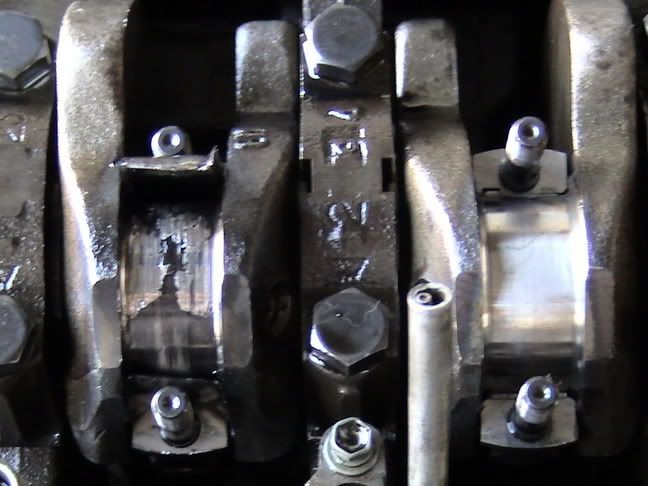

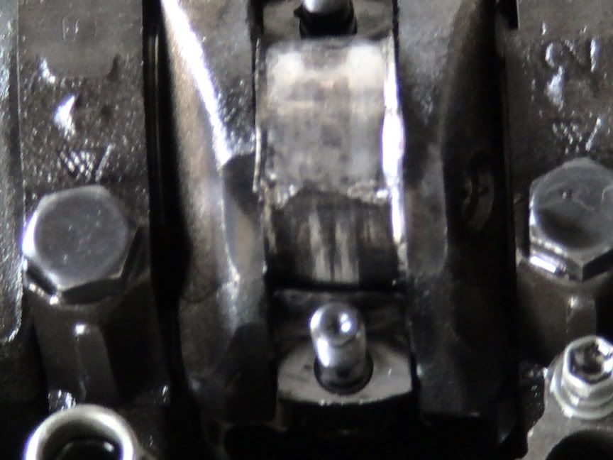

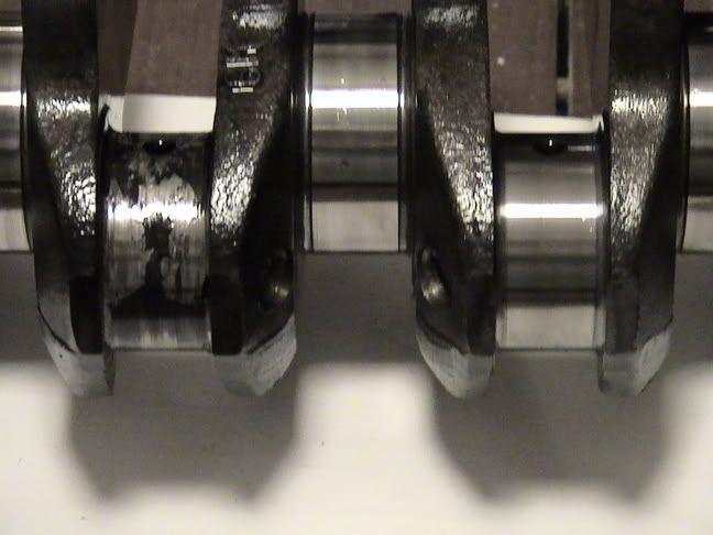

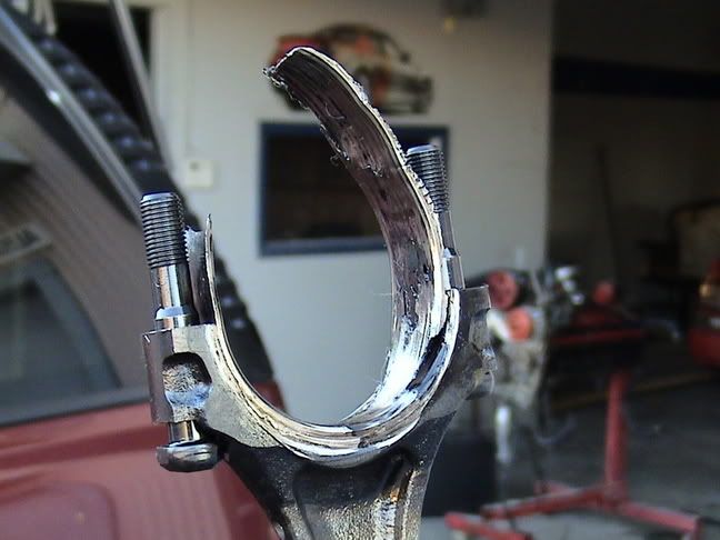

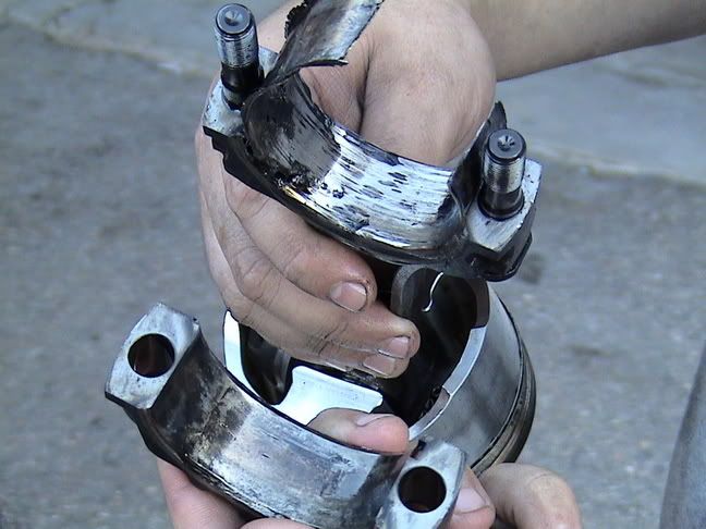

Well, got it torn down today. Took some pics of the damage, here it is.
Notice in pic #4, the color diff between the midpart of the rod to the part right below the bearings, got HOT as hell.
