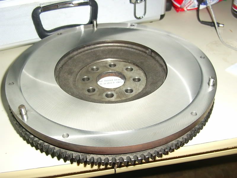

I have my FW pulled and i am going to have it resurfaced. But before i do what is the proper way of doing so, so i can inform the person machining it so the FW doesn't get F**ked and eat my 500+$ clutch away.

Any good machine shop should know how to do it right but just make sure they duplicate the 20 thou step up !! Cost 25 bucks :icon_bigg
