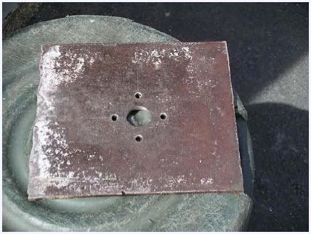

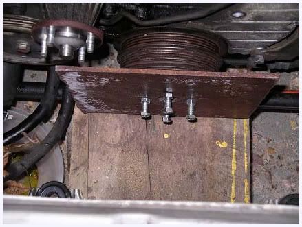

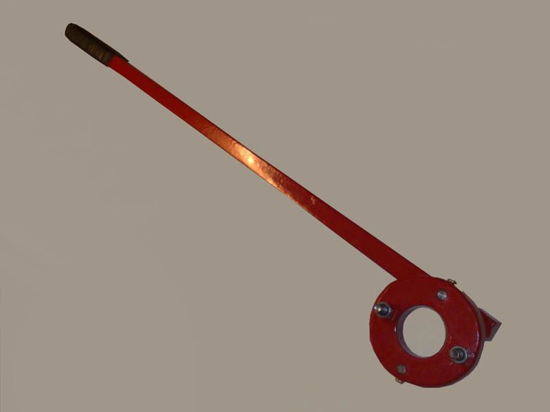

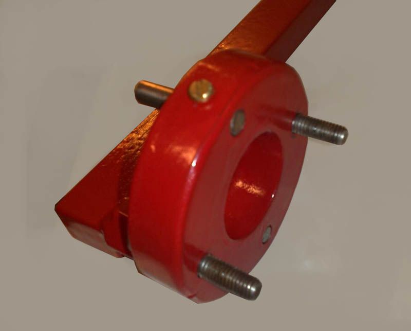

This looks as if this could work, found this on a forum some years ago, The red one was made by a guy in the UK.
