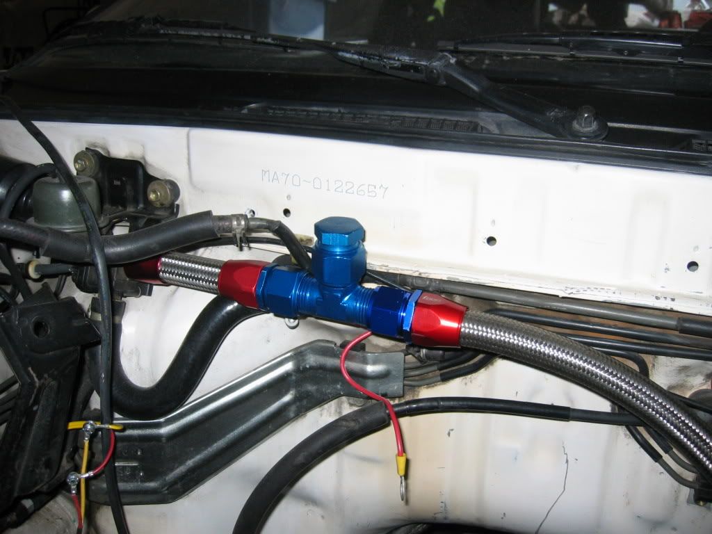

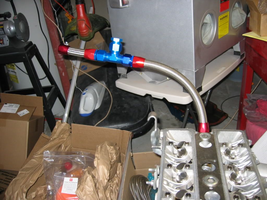

I took the idea of one of those NAPA radiator flush&fill kits with the plastic splice in T and made it out of AN fittings. The final hose had to be shortened and the clamp cover that goes onto the head had to be removed inorder to get the hose on (it was installed while the engine was out, but it hits the firewall lip and doesn't let the motormounts lineup properly when you drop the engine back in).

Is it gurgling out or is it rushing out?
If it is just overflowing a little it will stop once the air bubble pushes its way through the system. Make sure your radiator cap is higher than the hose at the back of the head, it takes a pretty steep driveway.
If it rushes out when you start the engine (cap off and heater on, not operating temp yet) it may be a blown head gasket.
I got all the fittings and lines from Summitracing.com, but if you know what you are looking for you can usually find it cheaper on ebay.

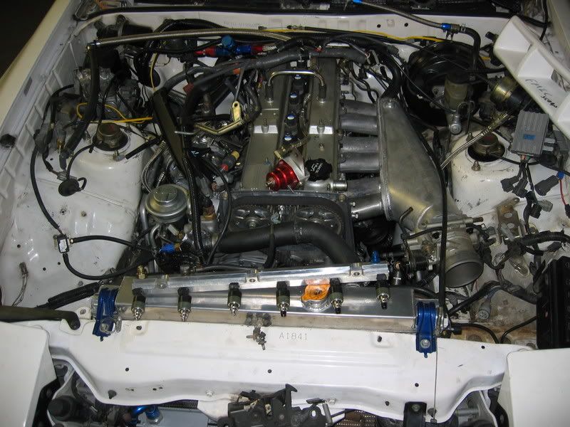

This is what it looks like with the engine in:
