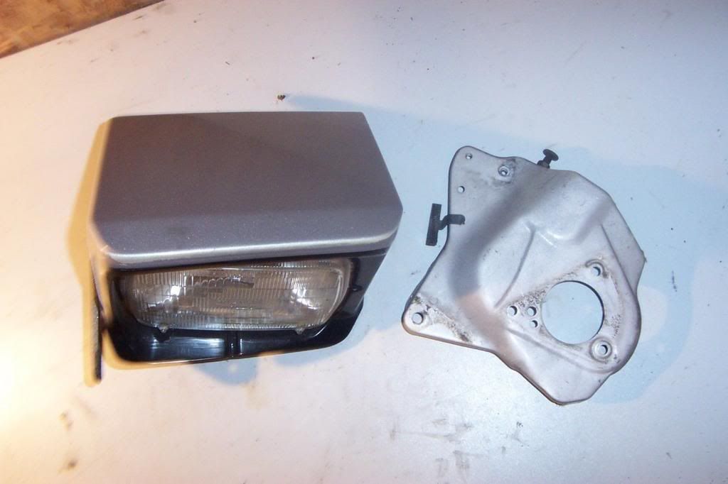

Well the seller says the cover came off an 88 so it would be the same silver as my car, and he also says it has not been repainted. I am having doubts about the second part. There is a strange line on the paint, where it looks like new paint and there are not rock chips or anything either which make me skeptical. If it has been repainted I doubt it would actually match my car well.
Should I just save the money on this and put it towards having the cover repainted by a reputable shop and blended? I plan to have my bumper covers painted in the future as well because they are starting to fade. Thanks for any input.
Here's the only picture the seller has. You can see the line I am talking about on the part where it bends down and meets the black shroud.
Here's the listing.
