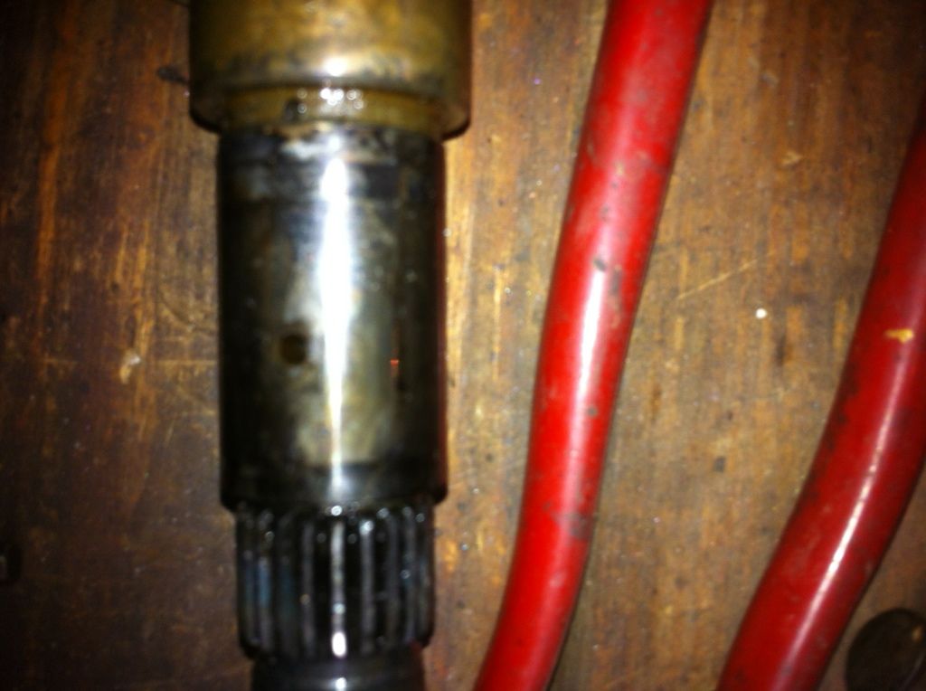

Started tearing into it today and found a few things that raise alarm to me..
Between both front and back cases there was no gasket, just rtv silicon. Toyota factory...idk but I'm guessing not! Also front bearing retainer was the same way. Also front input shaft has quite a bit of movement from rest of main shaft like right behind front main bearing forward. Normal? I know pilot bearing supports the shaft but it just seemed a bit excessive like 1/8" total. Everything else looks good as I was just going to upgrade a few parts but I just need a " oh no worrie, looks good,carry on" from someone would ease my mind.

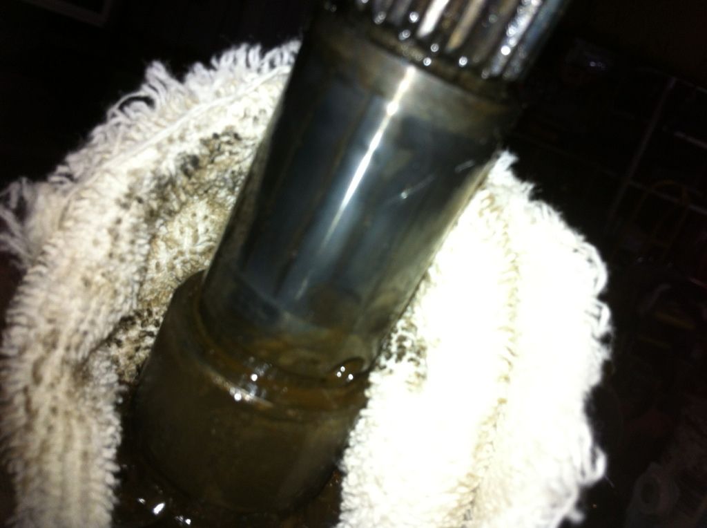

This is the front bearing. Does it look like a stock bearing or aftermarket or could that be known?
MightyAl
Jun 5, 2005
293
Chesterfield, MO
Yeah there is no gasket between the case halve or anywhere on the case. RTV is used to seal everything together. Unsure on the rest. If you don't have the TSRM I would suggest getting it before diving in much further.

Ya all of which your explaining is generally normal.
Toyota fipg. They use the orange on the manual trans and diffs. Tho the black will work too. Dm or toyota stocks the orange.

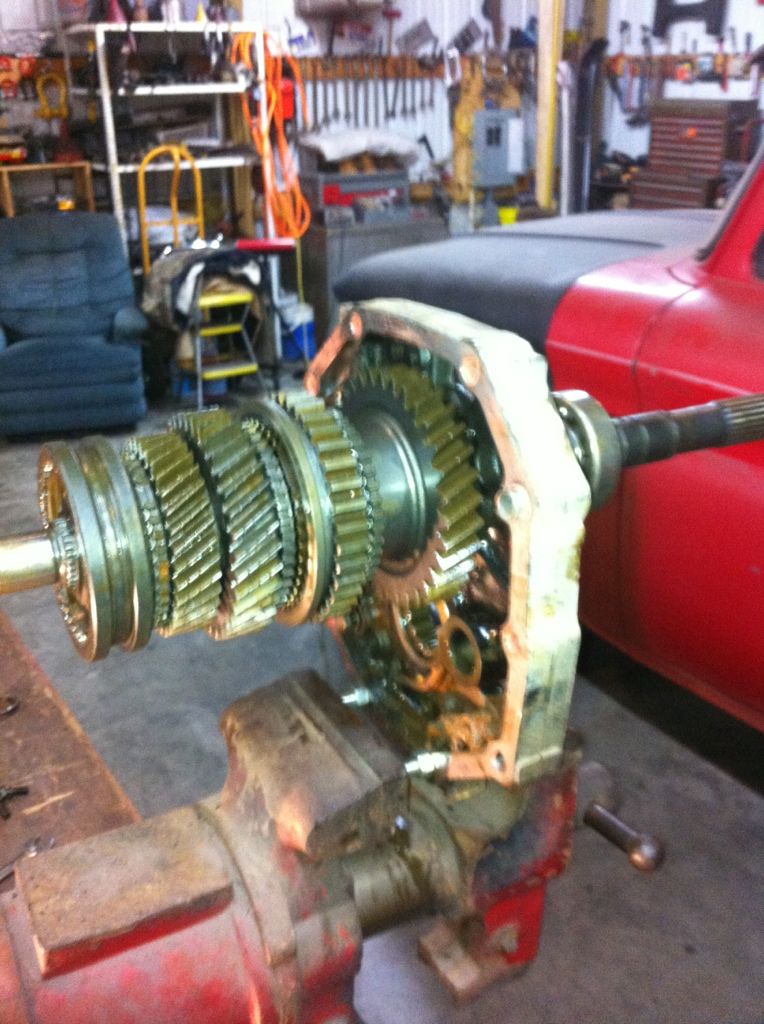

Got a little further today. Looks like the counter shaft in the back has got hot as well the two piece moon shape roller bearing went, the shaft had a blue/ burnt look. Anyone else seen this upon disassembly?

Riceman83;1893084 said:
Yeah that's the plan guys :) I forgot about dm cause marlin shift fork was out of stock yesterday. I'm not totally sold on the shift though. My tranny has 110,000 on it if it is all stock and looking at them I see no possible failure unless your trying to jamb gears or not using your clutch to shift. I don't do this for a living but that just my first impression after looking at the inside. Have got to the thrust washer yet from looking at the tsrm it looks like its gonna take me awhile to get to it.
replace the 1st thrust washer with the marlin crawler one.
I didn't and it came back right in my face at the drag stripe.
There was not much I could salvage from that R154 after that
