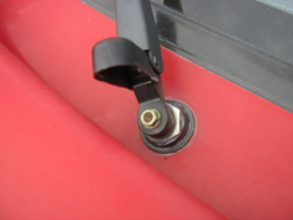

Seems some f??k face thought it would be fun to pull my wiper blade down when my car was off...well now its off track, when i turn it on it wipes passed the spoiler. How do u remove the arm in order to reset the blade.....I tried unscrewing the nut and well, Im assuming I have to losen something underneath, I dont know, can someone help.

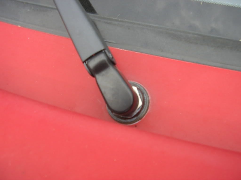

sure can, gimme a minute to upload pics...
EDIT: ok, here we go
pop the cover up and lossen the nut (or remove it all the way) and you'll be able to pop it lose. The spring tension may keep it on there though, so pop the wiper up if you're having issues.

Thanks a lot, I have it off now, so I guess all I have to do is turn the rear wiper switch on and then off for it to rest back in it's proper position, then install the wiper blade again.....?
