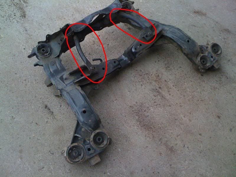

Does anybody have a picture of this brace? or at least a description of where it is located?
These things
