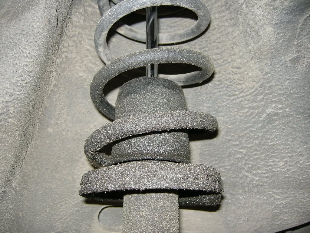

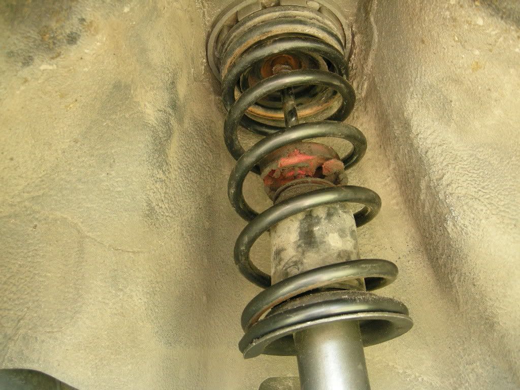

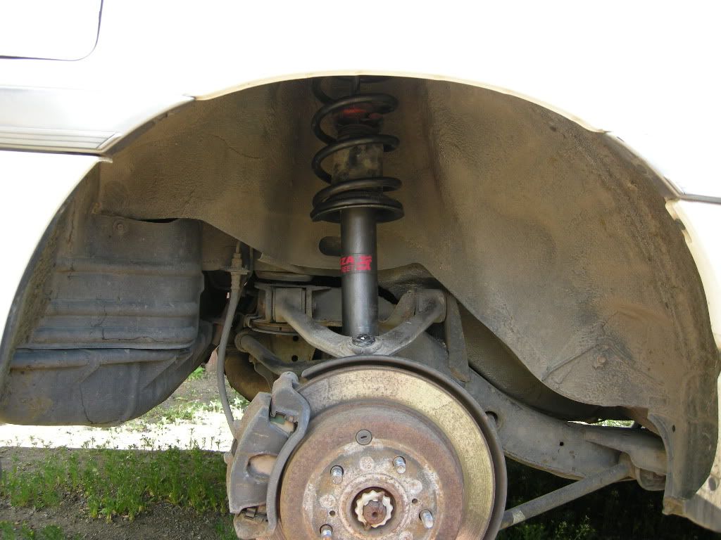

I pulled my rear wheels off to check the shocks (?) for signs of leaking, etc, and all I could find was 35lbs of greasy CRAP all over them. (Cleaned off for second pic)
I also noticed that this foamy pink bushing/stopper/whizbang was in terrible shape, and shredded to hell. I know this isn't a good thing, but can anyone explain to me why? (I do know from looking at the other side that it's supposed to be attached at the top)

Now, after all that, here's my question: is it a fair assumption that my shocks are done? Is there anything else I can check that would account for the noise? While I was in there I had a look at the rest of the suspension components and everything seems to be in good nick. Nothing is loose or wobbly, and nothing appears to be missing.

I had a very similar problem with my rear shocks. ended up replacing all 4 with konis and energy suspension bumpstops.
Those red foam things are the bumpstops to prevent your shocks from bottoming out over big bumps etc. mangled bumpstop = probably blown shock.
If you're up to it you can remove the coil over and manually check the shock. just move the piston up and down it should have good resistance and slowly move back to it's original position. A blown one will have uneven or resistance and probably will just stay in the fully compressed position

all that grease on the shock is from dirt and dust gathering up with the fluid leaking out of your shock. Basically they are done. With a leaking shock they will only get worse and worse until it quits working altogether. As for the busted up bump stop it could be that the shock is going bad as well causing excessive travel and the car hitting the bump stop and shredding it to bits.
IDK if Tokico has a rebuild option, i know that Bilstein and Koni have rebuild programs available.
