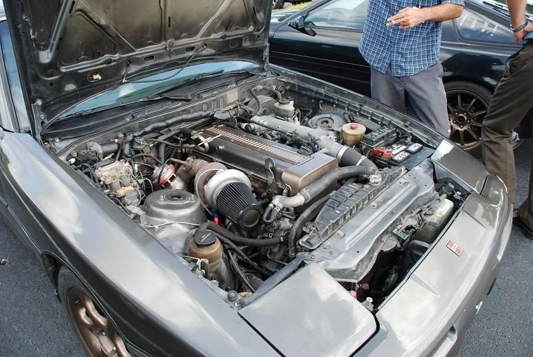

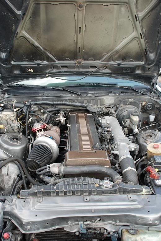

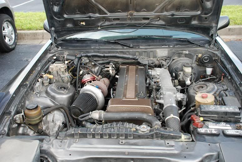

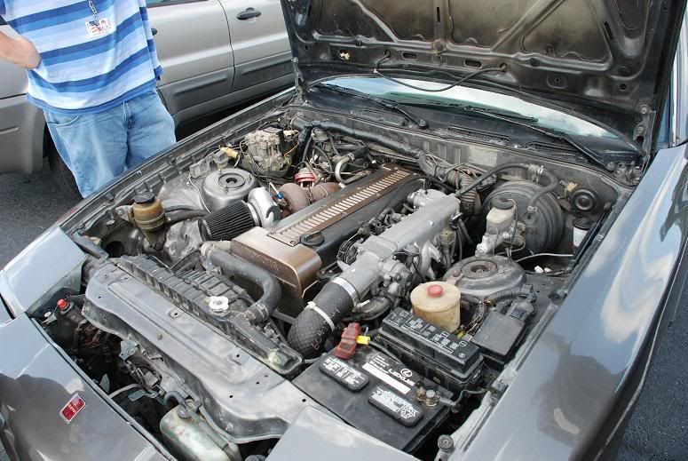

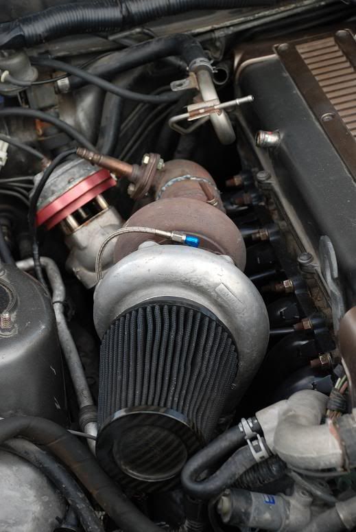

Well this past weekend Tissimo and i installed the single on my 1J
took awhile but finally got it.
FINISHED PRODUCT ON PAGE 2

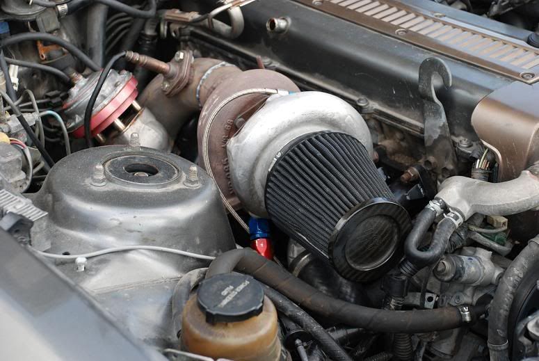

Garrett T04S 60-1
Drego Manifold
Turbonetics 42mm Racegate
Ebay SSQV
Everything else is stock down to the IC PIPING!
Arriving at the lexus Dealership
Getting it up on the lift to remove custom exhaust to remove the twins
last shot of the gay twins on my 1J
Getting closer
Getting frustrated :aigo:
Removing the twins was GAY. such a PITA
Twins removed BYE BYE! :naughty:
Just for fun got a shot of my new twin Photon Blaster :biglaugh:
Test Fitting Drewgo's Manifold
Test Fitting the WG
Test Fitting the Turbo
A little more Test Fitting to figure out the path of the DP and Dump tube
More pics to come. a friend of mine who took these pics left at 9 on Saturday night. so no finished pics yet. just took the finished pics like an hour ago during a smoke break at work. will post em tomorrow!!
man the sound is awesome. 3 inch turbo back on Drewgo's manifold is NUTS!!!
man im glad i didn't sell this thing HAHAHAHAHA :aigo: :aigo: :aigo:

yup got all the boost leaks fixed tonight and the WG creep problem fixed. bitch RIDES OUT!!!!!
i love the 1J!!!!!
The Reaper
Single, and lovin' it!!
Jan 10, 2006
1,909
Florida
hahahahahaha yea i admit i bashed the 1J pretty bad in the past. but DAMN this engine is AWESOME!
makes me want to get cams, 550's, afc, and tune it for 18 psi.
right now its at like 10 or 11
