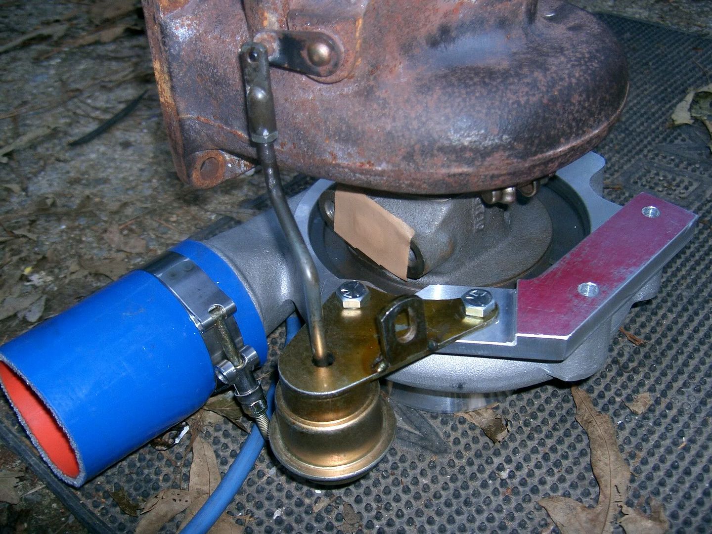

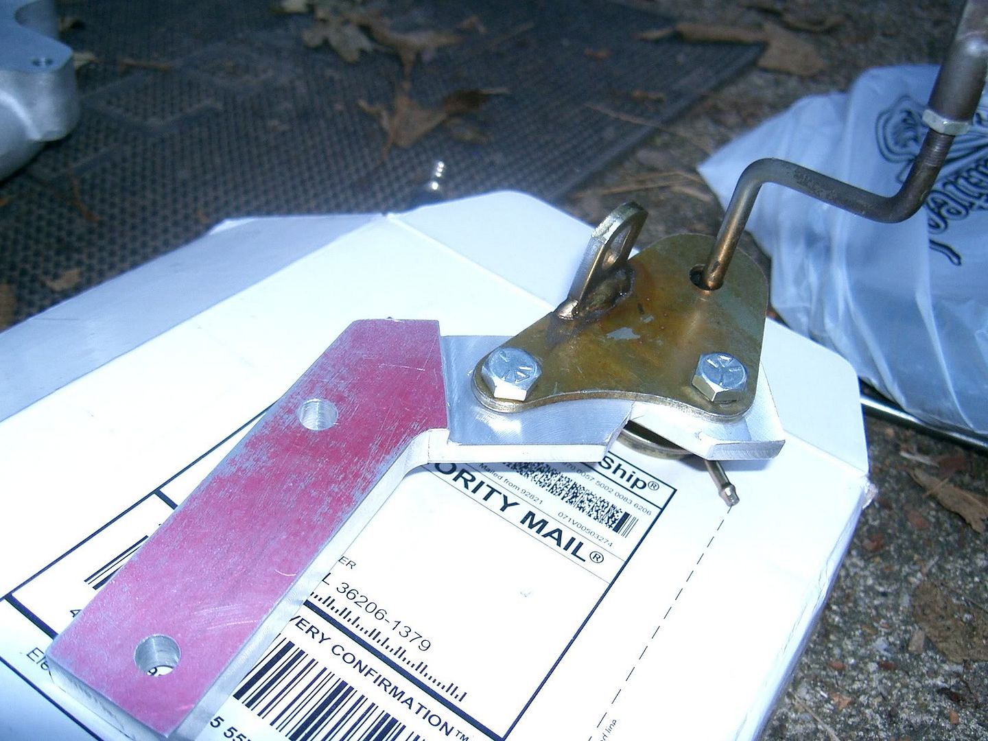

Turbocharger options.
Above left is the Greedy 20G kit turbo (TD06-20G) with the 14cm² housing. Above right, is the turbo I'm currently using. It is a Mitsubishi TE06-24V, which is basically a 25G/T67 with an anti-surge housing, still utilizing the 14cm² exhaust housing for quick spool up. The turbo, with the same housing is rated to 630RWHP, and was originally intended for use on a RB26DETT engine before making it's way from Japan to the US. Also, the 4 inch inlet pipe, Lexus AFM, and Blitz SUS filter. I had to use a N/A Powersteering reservoir due to clearance issues.
