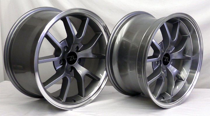

I was looking at a set of new FR500 rims, and the wheel bore is 70.6mm
Our hub bore appears to be 60.1mm. Now I've seen alot of guys put mustang wheels on their cars, but I haven't been able to locate
a hubcentric spacer to fill that bore gap. My questions are:
Am I not looking in the right places for a spacer ring?
or...
Do those that have Mustang rims, simply do without the rings, and hope for the best?
Those who are using Mustang rims- please chime in, and lemme know what experiences you've had.

Update- I did find one place, that has 60.1mm to 70.4mm.
Would this be precise enough to help center the wheel?

I know this subject might fall under the massive wheel wheel fitment thread, but the wheels I'm thinking of using, are FR500 replica's, in 18x9+30 and 18x10+40.
Do these sound like reasonable sizes/ offsets? I'd rather not roll the fenders, but will if necessary. Also, I have coilovers, so they're a bit slimmer than the stock spring/ shock combo.
I would prolly opt for 255's in the front, and 275/ 285's in the rear.
