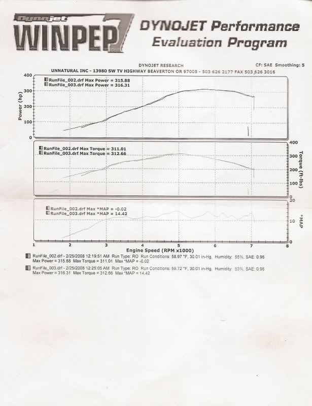

Dude you dont need to buy all that crap.
my bros daily driver makes 316whp with 3" dp/exh, FCD and a front mount that's it. Naturally hits about 14 psi. He's already put like 20k miles with no probs so far.
Also if you want to go over speed limit just cut the sp1 wire or put it on a switch. yeah it will throw a cel but so what. As soon as the ecu turns off it'll go away.
Btw, here's my bros chart:
