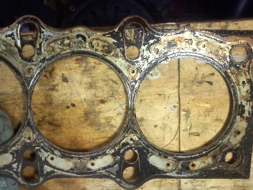

Ok guys.. i have a compression problem with my 2jzge, every cylinder is ~40 psi with the exception of 1 being even less. I added oil to the cylinders and saw no change.
So i pulled the head off, cant even tell if the head gasket was blown (i'v never ran the engine).
Then i decided to check the valves.. so i added some liquid to them and none leaked. good! but then i tried blowing air into the exhaust manifold and the second picture is what i found.. yet no liquid leaked through...
so i guess the real question is: is it normal for air to flow through backward or do i need some valve work?

It's your bottom end. Piston rings are worn out. Apparently all of them.
Excuse me, I take that back. For some reason I misread that you saw a change rather than no change in compression. In that case that is a mystery. Cause usually when you add oil and see no chance it's the top end. But you say no leaking valves, and no sign of BHG. Sorry for the confusion.
Unless of course your piston rings are SOOooo worn out that the wet test wouldn't make a difference. No major scoring in the cylinder walls? Possibly it overheated and collapsed your piston rings? I just guessing here.

i could be the head gasket i couldn't tell from looking at it.. there was air coming out of my radiator though with no coolant in it. witch made me think it was super blown, but i cant tell.. I'm still confused about the valves still because the fluid isn't leaking out yet i can blow air through them the other way with my mouth.. so valves.. good or bad?
added notes.
-compression test was done with throttle open.
- full battery hooked up to a charger
- has cross hatch in cylinder walls still but engine condition is otherwise unknown

whats the difference between that way and the way i did it?
looks a little blown between the cylinders?

Since the head is out. Why not get a valve job and replace the gasket and call it a day.

i wish there was a shop around here i trusted.. or i would. I'm 1 7m and 3k down after i trusted the only one around here with that.. but i guess since it has to be ether the head gasket or valves (right?) that's what ill have to do eh?
