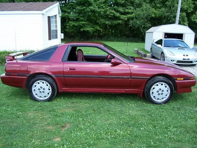

you can still buy the moldings brand new, but they are really expensive (like $800) I replaced my 87 moldings with 89+ that I bought from a guy on this forum for a MUCH better price. Just be patient finding them.
p.s. old moldings vs. new
