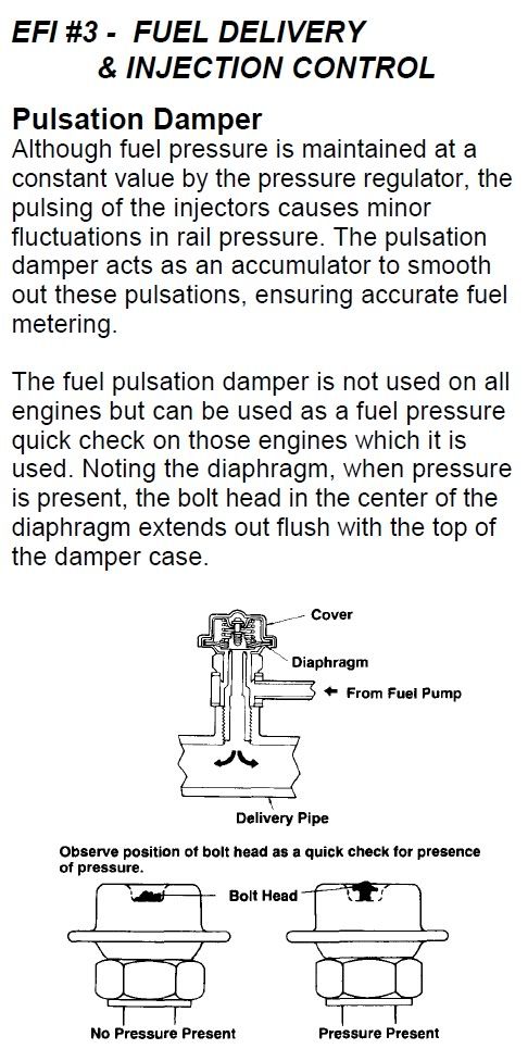

http://www.cygnusx1.net/Supra/Library/ToyotaTech/
•EFI#3 Fuel Delivery & Injection Controls
also a forum search of pulsation, damper

Thank you very much for the links. I admit I haven't searched the forum, but it looks like it doesn't returns any results.
So, if I get it right, the little screw has just diagnosting purposes?

It was explained to me by a Toyota tech, a VERY long time ago, that the screw in the FPD is used to set the damper's opening pressure at the factory. Unless you know what that pressure is and have to tools to adjust it while tuning it it's a bad idea to (pardon the pun) screw with it.
