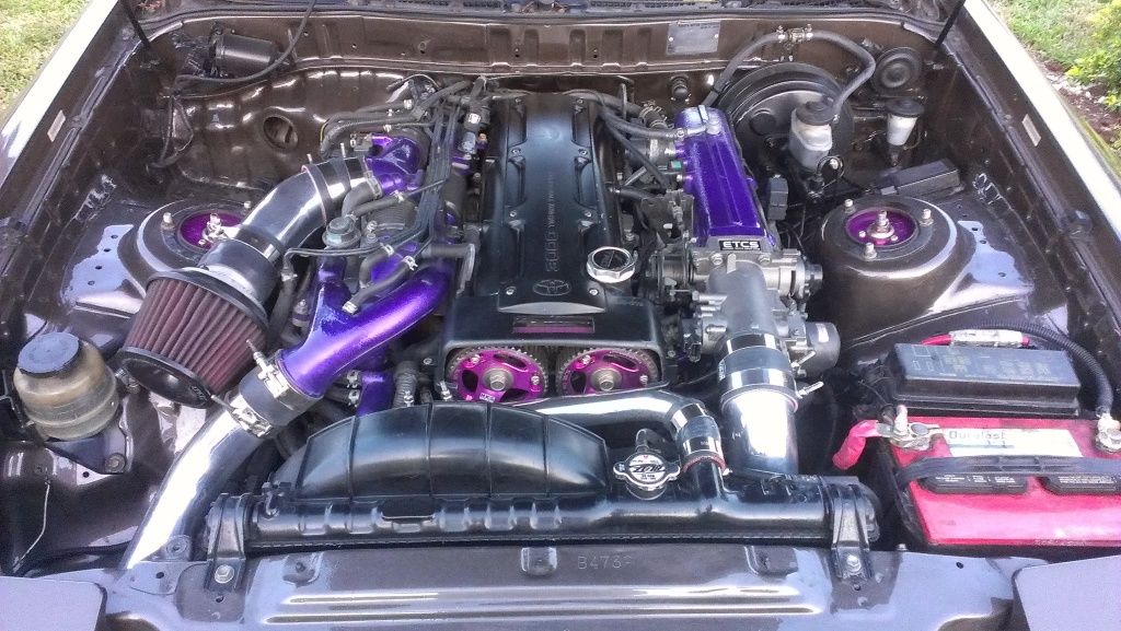

Mines tucked and I showed pics in my build thread

^^ yours is proper and either abes or Andy's is nice too, I feel guilty for not knowing who tho :(
How much is grimjacks bay tucked? It's clean as shit tho
