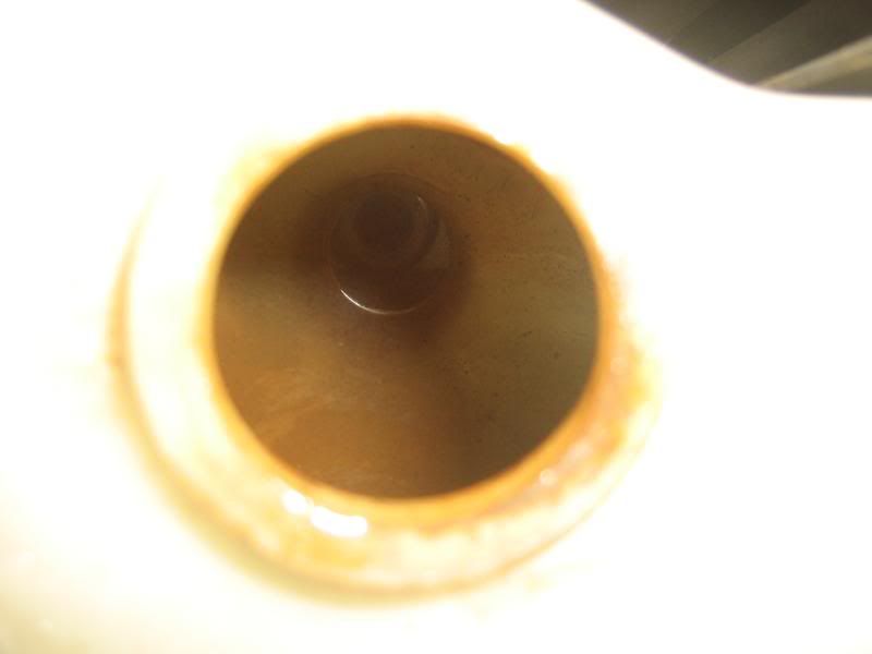

I did say I wasn't sure if the discoloration would happen with water as opposed to coolant. Everything I've found about the subject only mentions coolant reacting with the exhaust gases, so I guess there's no reason to think it would happen with water. Yes, the brown is most likely rust then (since you said you already checked the coolant for oil). But even if it's not the cause for the discoloration, exhaust gases are still getting into the cooling system - that's what's been causing coolant (or water) to get pushed out the overflow. Sorry to whoever thought my post was "unhelpful" but it answered his original question and nothing was wrong...I was just raising a side question I wasn't trying to present it as fact...

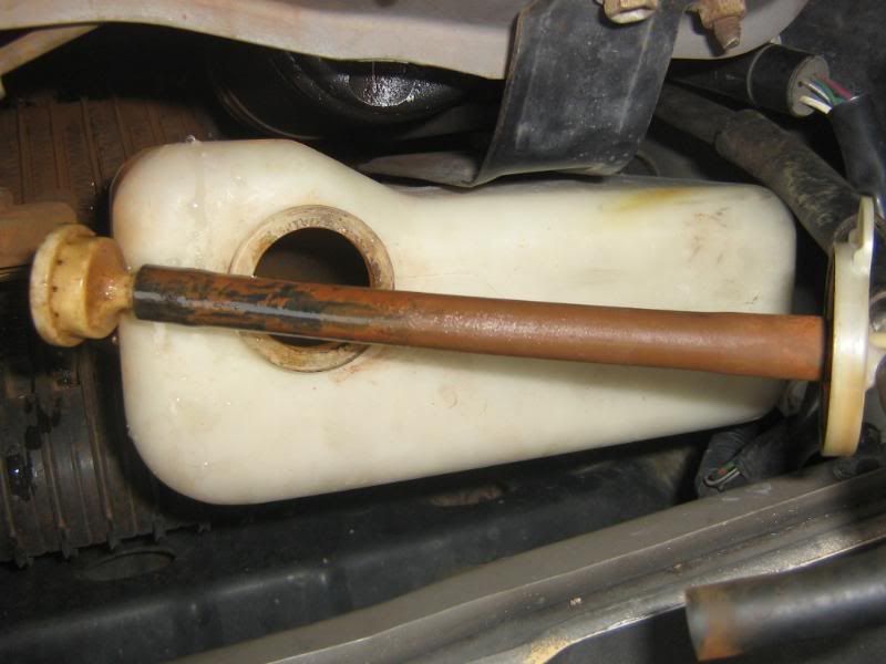

This is what the coolant(water) looks like, its not oil.
See the rust colored dust on the intercooler from it overflowing. Its a brown powder that wipes off.
The water in the res is clean and clear, its just the inside of the overflow that is discolored.
