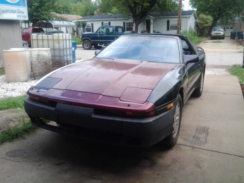

Anyways... so this is what it looked like when I got it off the trailer...

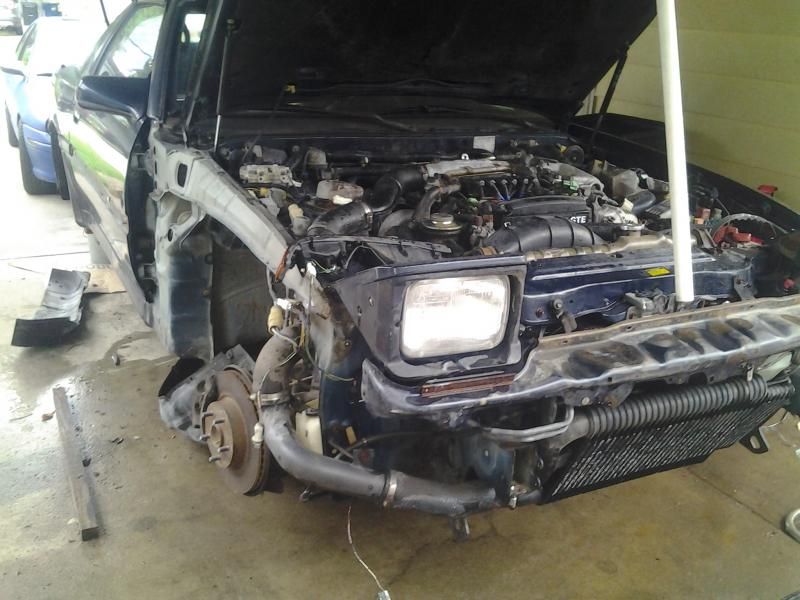

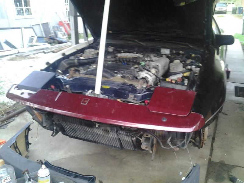

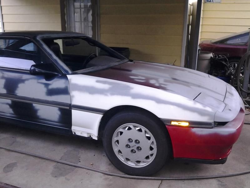

Got it home and decided to tear into the body. The front driverside had been in a fender bender... the passenger side front fender was rotten... and it had a bit of rust on both rear wheel arches. The hood had been used as a jungle gym by the p/o's kids so it was done.. Back to the parts pile.

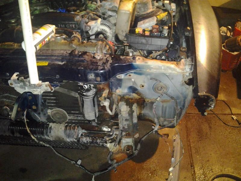

As I started pealing sheetmetal off the car... I realized the "fender bender" went a good bit deeper. The headlight support bracket was mangled, the bumepr support was bent.. the front mounting lip on the driverside fender was gone... the nose cone support was bent...
Started swapping parts...

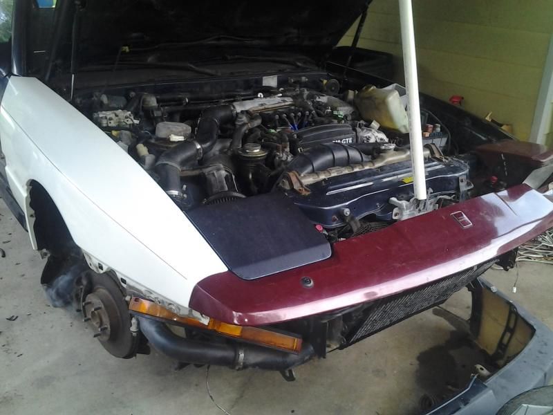

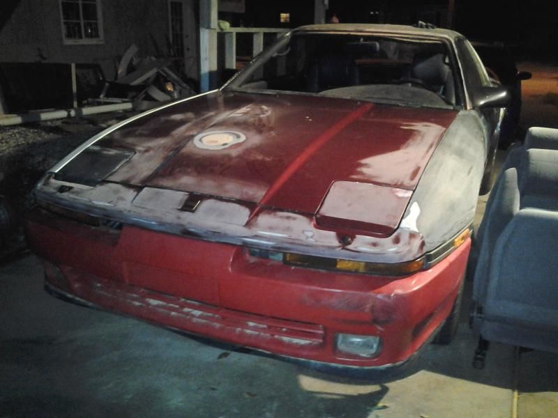

Hood and a chopped up 89+ bumper I had laying around... I really wanted to go 89+ but this was the only one I had... wasnt sure about it...
Back together with '87 turns...

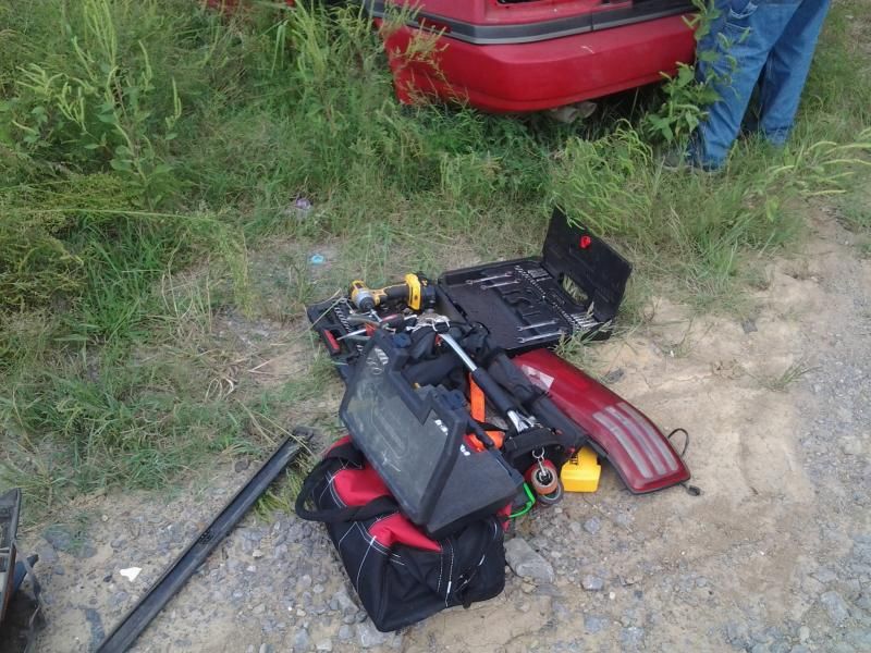

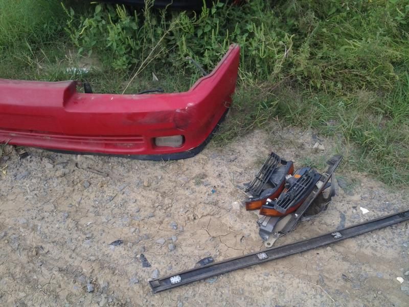

Then I got wind of a complete 90 NA car sitting in a junkyard surrounded by weeds so we headed out. The car we found was MINT... killed me to rob it of parts but the guy at the yard wanted 1500 for the whole car... it was a base model auto NA that didnt run and had been sitting just as long as this one...( I know I know... not a bad price for a rust free mint '90... but dont have the space or coin to spare) so $200 later, I nabbed the entire front bumper assembly with fogs, turns, grills... the rear hatch and 3 pc wing... the tail light housings... both front seats, most of the exterior mouldings, and mint climate control.

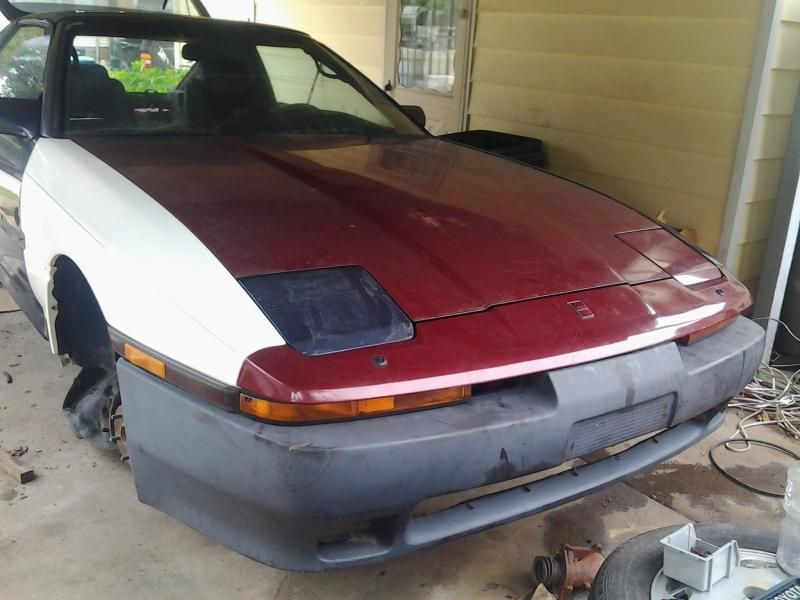

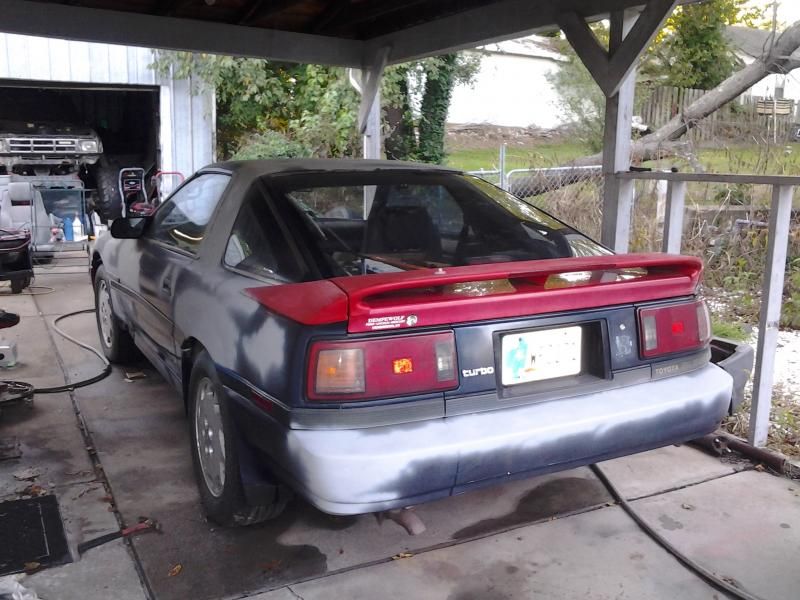

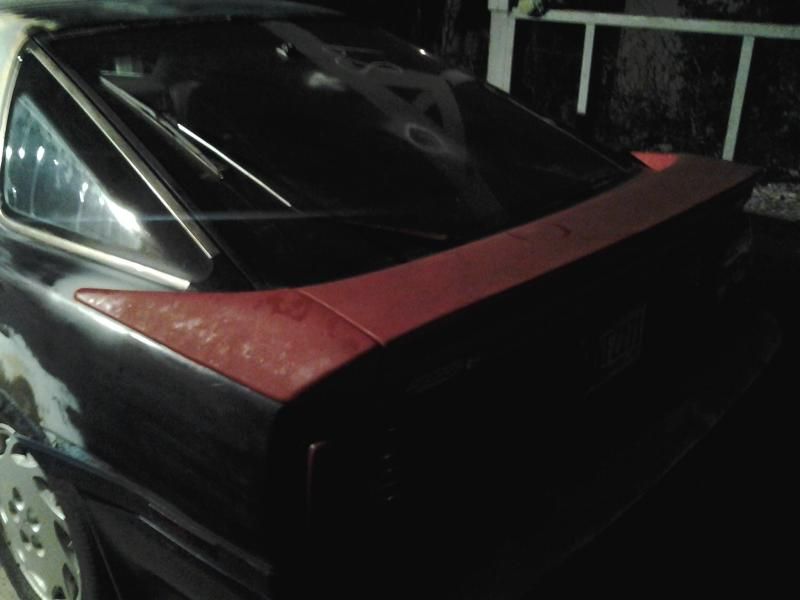

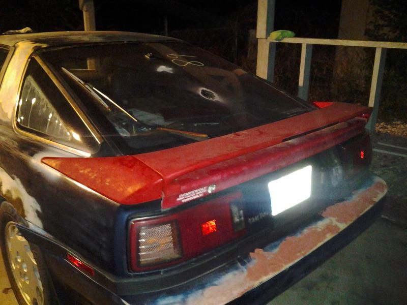

My hatch glass was covered in nasty peeling tint... the new hatch from the '90 was clean. Swapped on the new hatch and kinda/sorta half arseed mounted the wing...

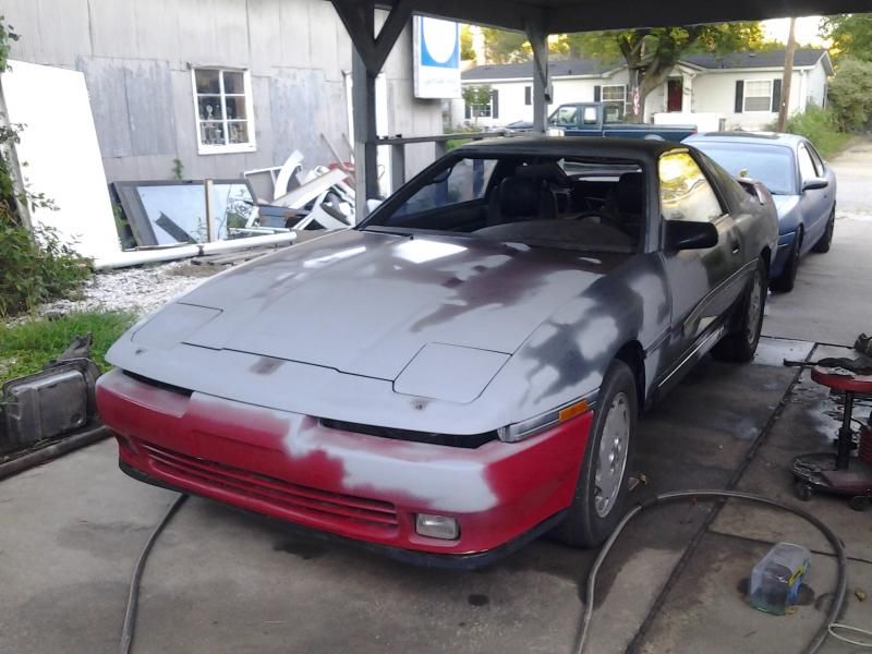

Swapped the front bumper assembly...
Then realized that the nose support is different... so still can't use the 89+ turns or grills... not sure if I'm going back for the nose support or if I'm going to leave it as it is...

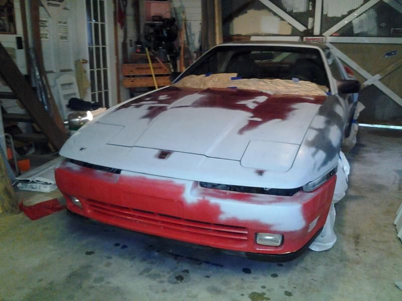

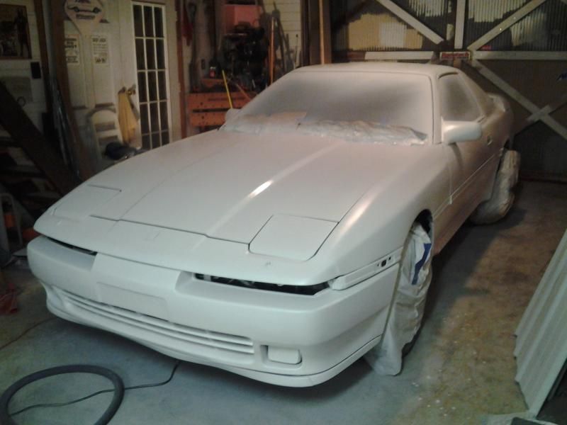

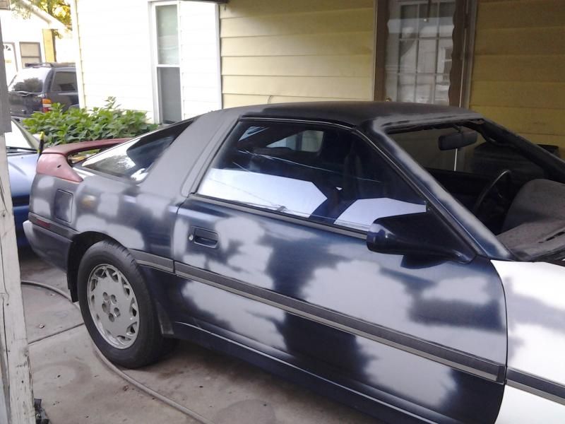

A few days of grinding... sanding... and primering...

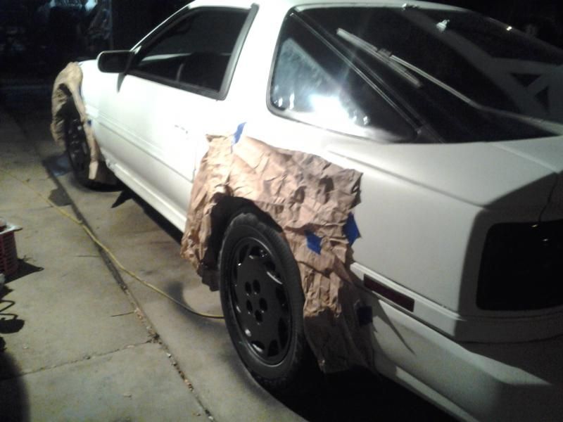

Now... this car is going together somewhat DGAF style... money spent on go... not show. Cant see dropping 5k on a paintjob for a car that I have less then $1100 in... so dip it is. I've dipped a few cars and the outcome has always been decent... this one didnt turn out how I would have liked... but its far better then what it was...
I rushed it a bit and had water trapped under the spoiler which ruined it for me... most people dont notice it right off but eventually I will peal it and re-spray it. But its good for the time being.

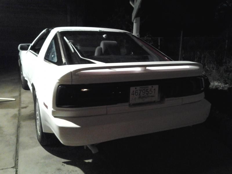

I decided since my tail housings werent perfect... and I was stuck with using '87 turns... I would spruce it up a bit with some niteshades... 2 coats. Hard to tell in the pics but they are just smoked... not completely blacked out. Hid the scuffs pefectly and the contrast on the white was just what I was looking for.

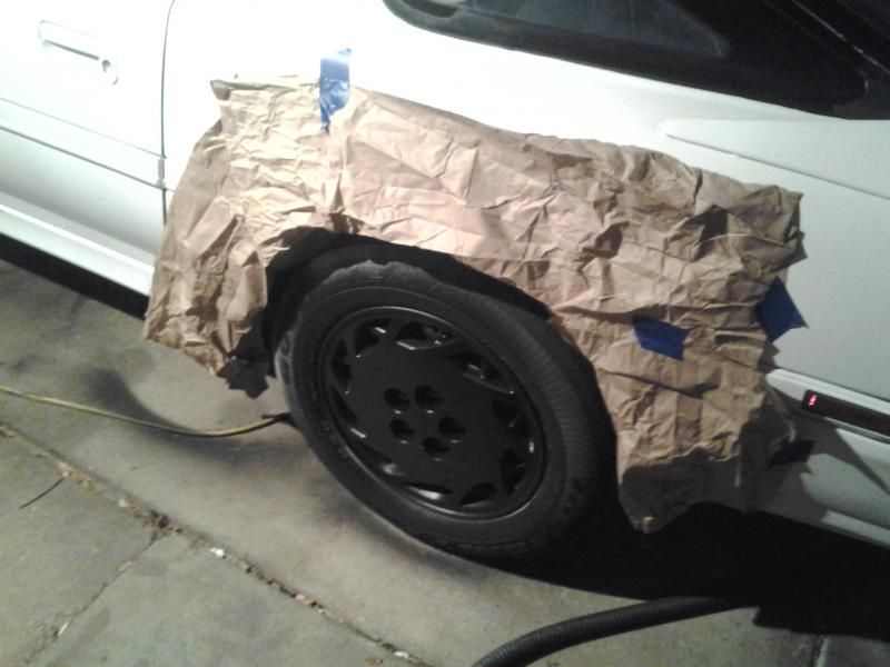

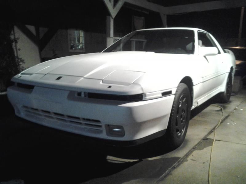

Now the wheels were in rough shape. They had been curbed... scuffed... and were pitted in some areas. A friend had 1/2 a gallon of black dip left over from another car, so I dumped it in my gun and shot the wheels lazy man's way. Laid a few coats on then pushed the car back and laid a few more. Turned out really good and made the wheels look 100x better.

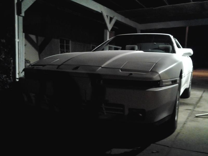

And thats how it currently sits in the driveway. I had a small issue come up last week while driving... the rear hose that goes from the EGR cooler failed. The hose failed because of an exhaust leak that was blowing right on it burnt the hose... it didnt peg the gauge but apparently it was enough. Since installing a new hose, the temp was very tempermental... random high spikes.... puking coolant out the reservoir... after talking to a few guys here, picked up a block test kit and it popped positive (very lightly.. but still there) for hydrocarbons. The cooling system had been flushed with distilled water and fresh coolant during getting the car running... so any change with the test ment a problem. The fluid didnt turn bright yellow.. but a pail greenish yellow... blah.
