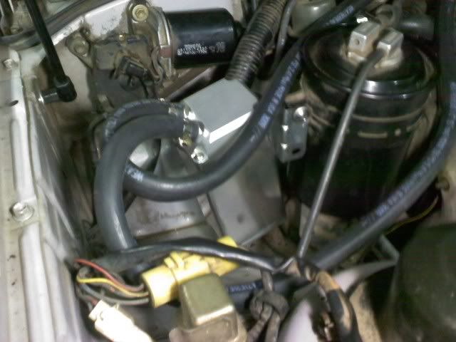

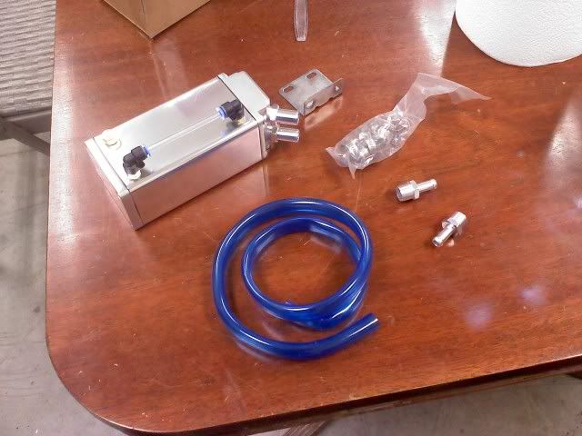

Oil Catch Can(I Know It's Not A Turbo, But The N/A Throttle Body's Get Oil Build Up As Well)

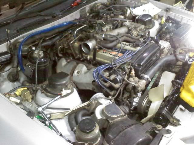

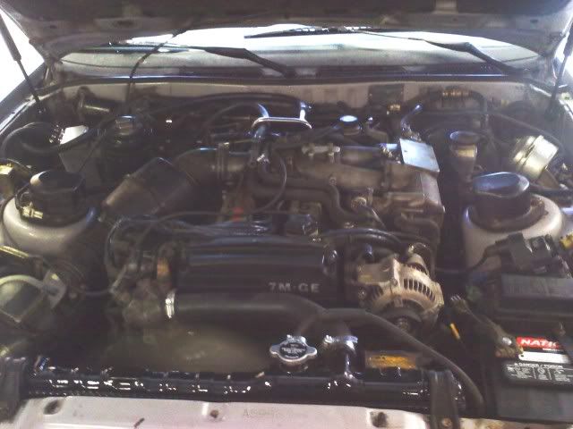

Another Thing That Was Odd About The Whole Car Was The Dip Stick Location.
All my Supras had it back towards the back of the motor....This one has it under the distributor and the normal spot looked to be blocked off or non existent....

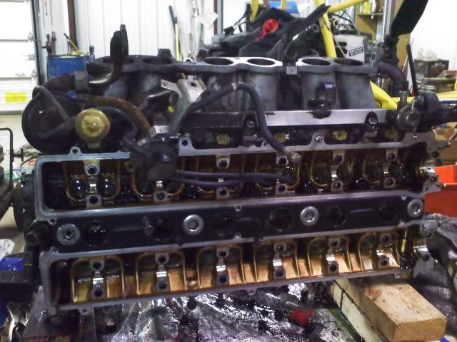

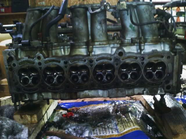

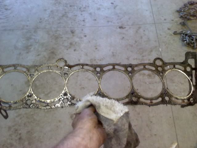

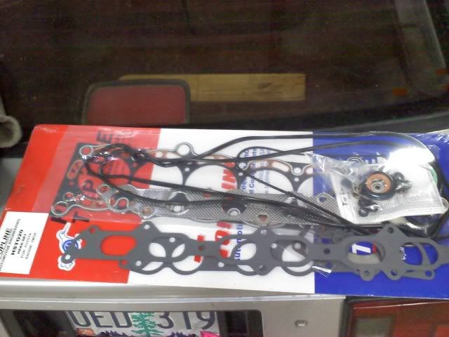

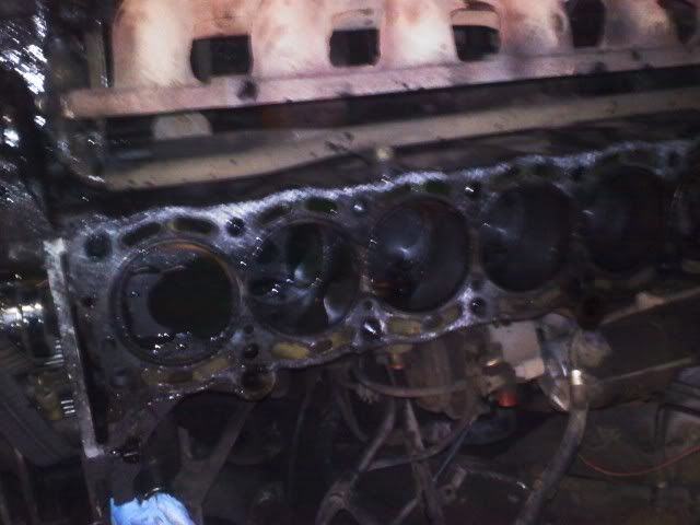

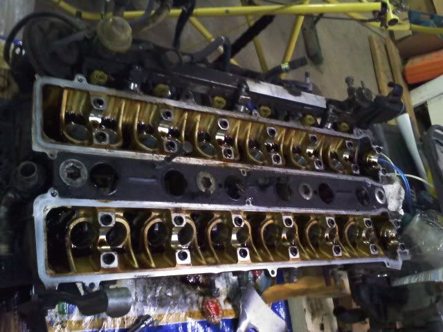

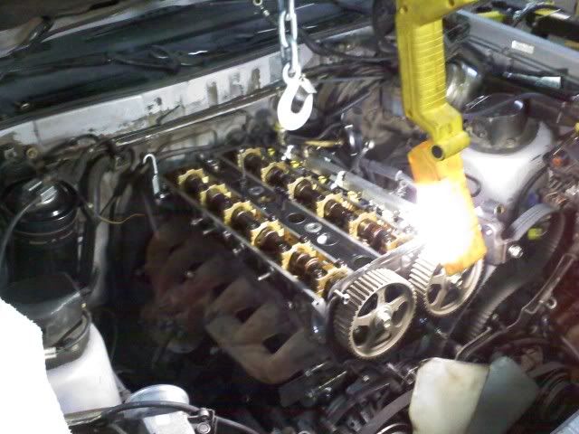

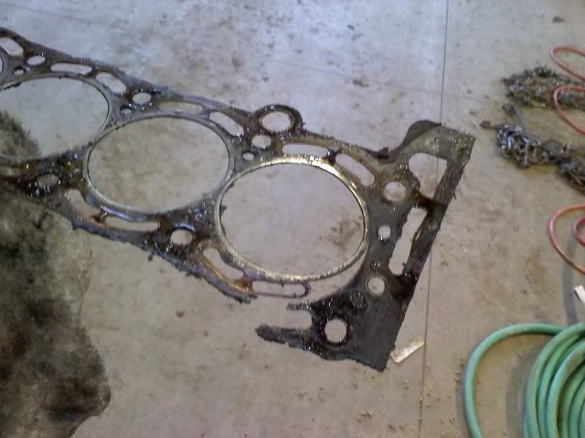

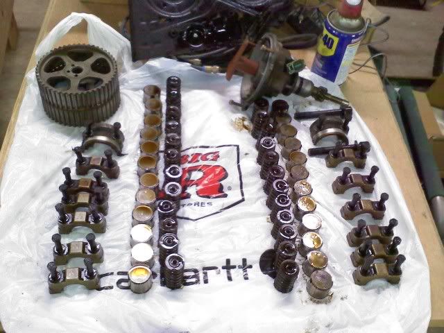

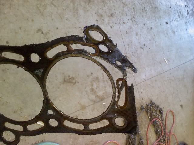

Well, my TopLine Head Rebuild/Gasket Kit came in, so i figured it was a good time to update. I've used TopLine on all my stock rebuilds and they work Great. I spent 125$ on it, after shipping, and received it in 3 days. I started cleaning the valves with some diesel fuel and a medium brass wire brush. Man those exhaust valves were Caked on. Never seen it that bad before. Noticed the valves weren't closing all the way due to the build up on the valves and the valve seat. Cleaned em up and Shazaam! Nice and tight. ;] Noticed about 4 valve seals were toast as well, so replacing all of them just in case. Looks like the head gasket had been replaced before, but the bolts were on pretty loose, so 85 Ft/lbs with a tapped and cleaned bolt hole will work out nice. :D

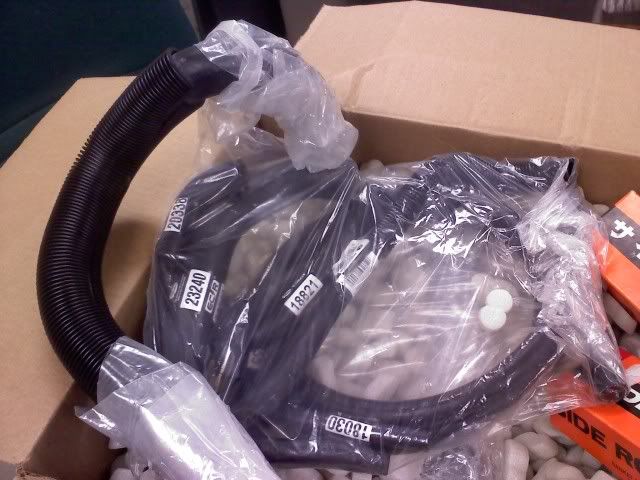

First supra i've ever had that had 0% rust in the water jackets. I'd like to keep it that way....LOL.....Got a complete hose kit on the way, new brake pads, new radiator, Tie rods, oil catch can, water pump, and new power steering hose on the way from DriftMotion. :D

TopLine Complete Head Gasket Kit

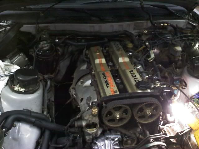

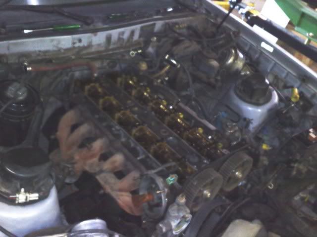

Getting ready to remove head
Head Gasket

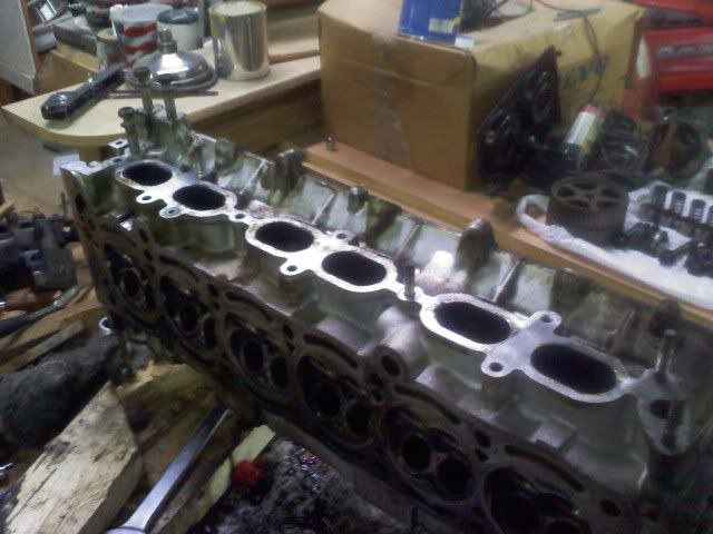

After removing head

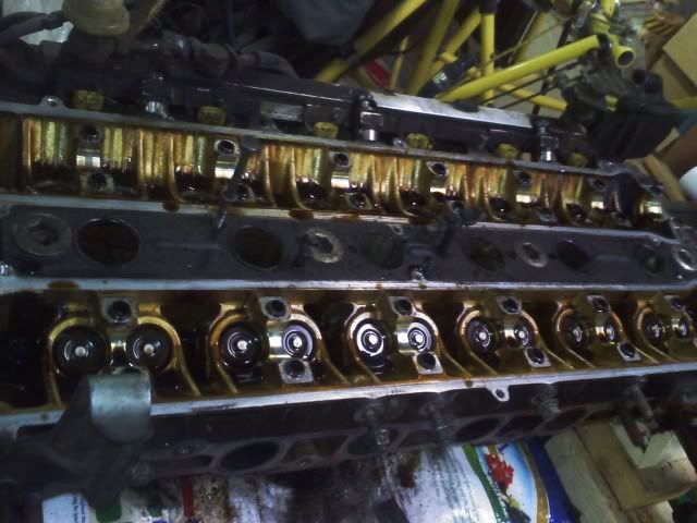

Head before valve spring removal
After spring and valve removal
Soaking the valves
Top end removed and organized

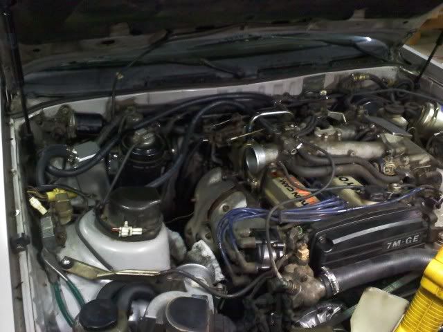

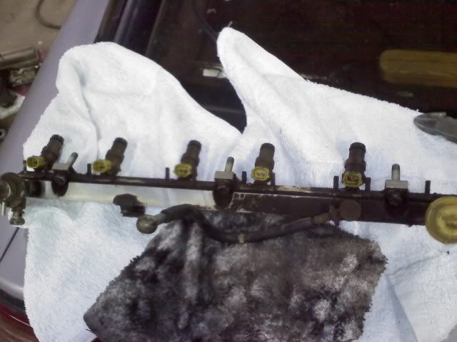

Got all my goodies in from Driftmotion and worked on the car all weekend and afternoon. Cleaned all the valves with water and installed the new valve seals. Cleaned the head and block, installed the Head Gasket, ETC. Had a few hangups, because i shattered...yes shattered....the crankcase to valve cover hose...and didn't have time to order another one.(Please note that I'm out in the middle of NOWHERE....and that pipe is Expensive for what it really is......) LOL...Half of the pipe was fine, but the upper was brittle and cracked....so i cut the hose in half and i added a 90Degree AN fitting and piece of hydraulic hose i had laying around...Yep...It works great and you can't even see it. SUCK IT, Expensive hose ;] Fixed the leaky roof, turns out all that was leaking was the drain hose that runs out the side of the unit down the pillar to the ground. Re-Siliconed it up and the rest is history. I did find a giant hole in the exhaust near the rear.... blowing onto the wheel and brake line..... gotta fix that Pronto...glad there is no damage. Oil catch can is installed. We'll see how it works ;] It is Nice and worth the price from Driftmotion. The hose that comes with it isn't that long and is Really weak, and the bracket is not that universal...This Is DEFINITELY not Made for a Turbo with ABS...I'd hate my life while trying to find a spot to place it with that bracket...LOL....Luckily this is not a turbo and a non ABS ;]

Lookin good! If I am not mistaken, Cressida 7mge's had the dipstick in the front location instead of the middle, though I didn't think it would even work with a mid sump pan.. not to mention you have a supra 7mge intake manifold, pretty weird.

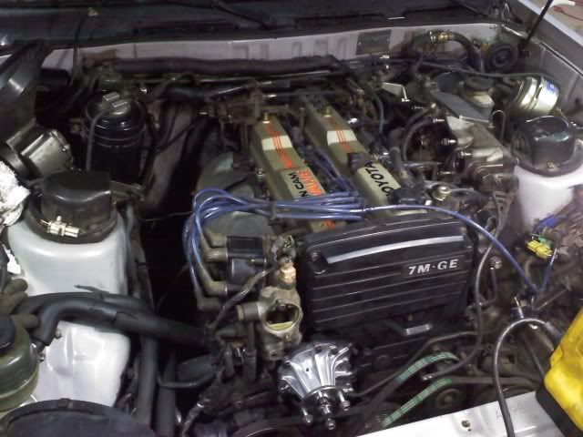

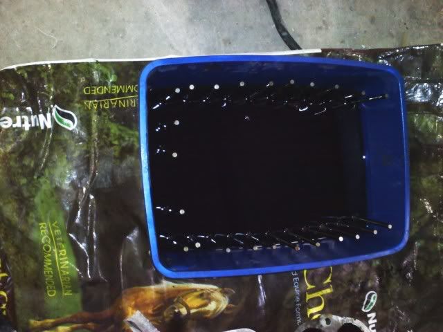

Indeed. I figured since it was the first year, it could have been different than other years. What i do know, Is the head gasket HAD been replaced. Though it was about to be toast because of incorrect torque specs. LOL Another weird thing, was the CRANK pulley. It looked WAY different than my previous ones. It had some weird addition in the middle that none of my others had. Looked like this.

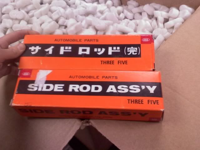

bioskyline;1721445 said:
side rod assy??? whats that?
LOL, Brokem Engrish, AKA Tie Rods :D

ahhhhh tie rods.... gottcha!
Yep. At first i was like, WTF is that...
