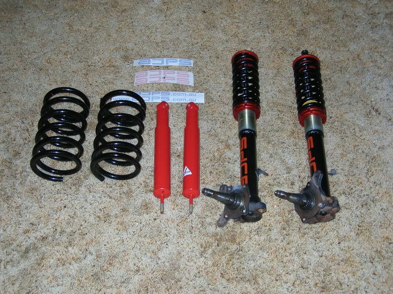

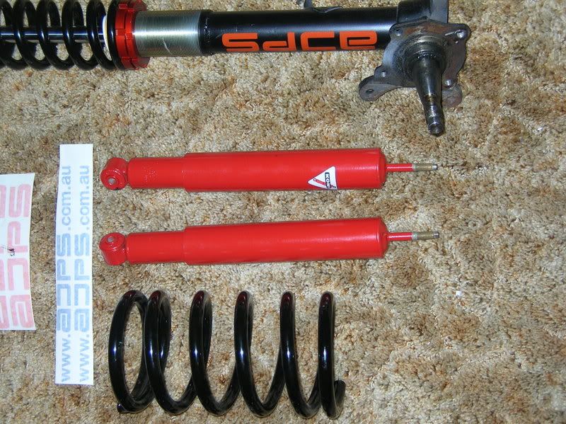

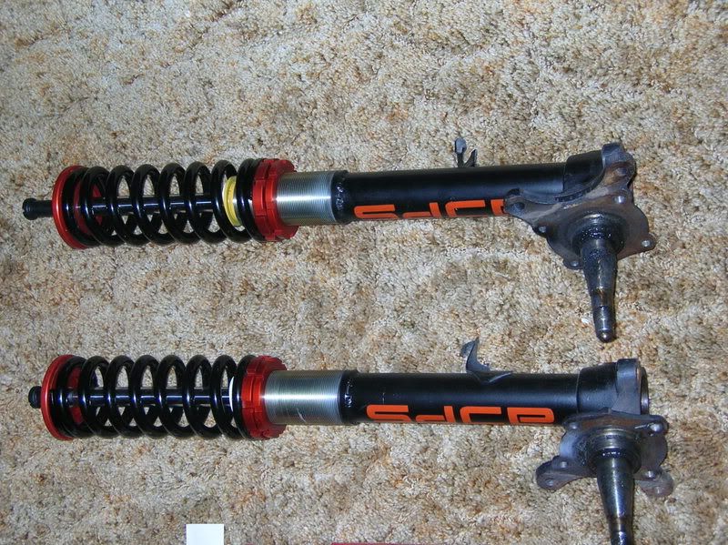

Suspension Being made as we speak:
Front:
Custom Coilovers
RA60 strust cut down for 2.5 degrees of negative camber
Koni Yellow inserts
9kg springs
T3 Camber top

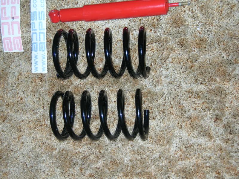

Rear:
6kg springs
Koni Red shocks
Full set of super pro bushes
