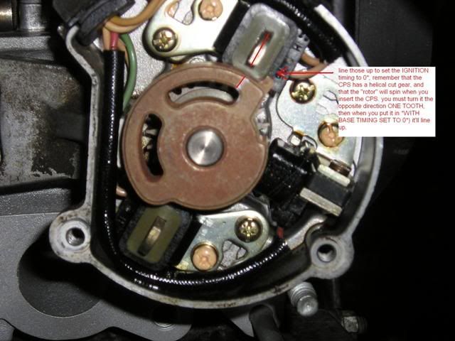

if the cams are alligned with the matchmarks on the back timing plate, and the crank at 0*, do this:
another thing: if you set the base timing (cams and crank), rotate the motor, and when it comes back around, they're not lining up anymore, chances are you bent the timing belt tensioner. if that's bent, the belt won't hold time.

Dude that CPS is not aligned right (at least by your pic) if the cam gears are on mark and the pulley on 0.. Go back and look at the pick Shaeff posted. When you install the CPS it will turn on you. Turn it more left and then insert it. It should rotate into the correct position.
