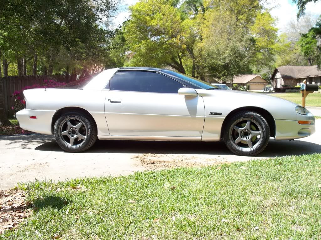

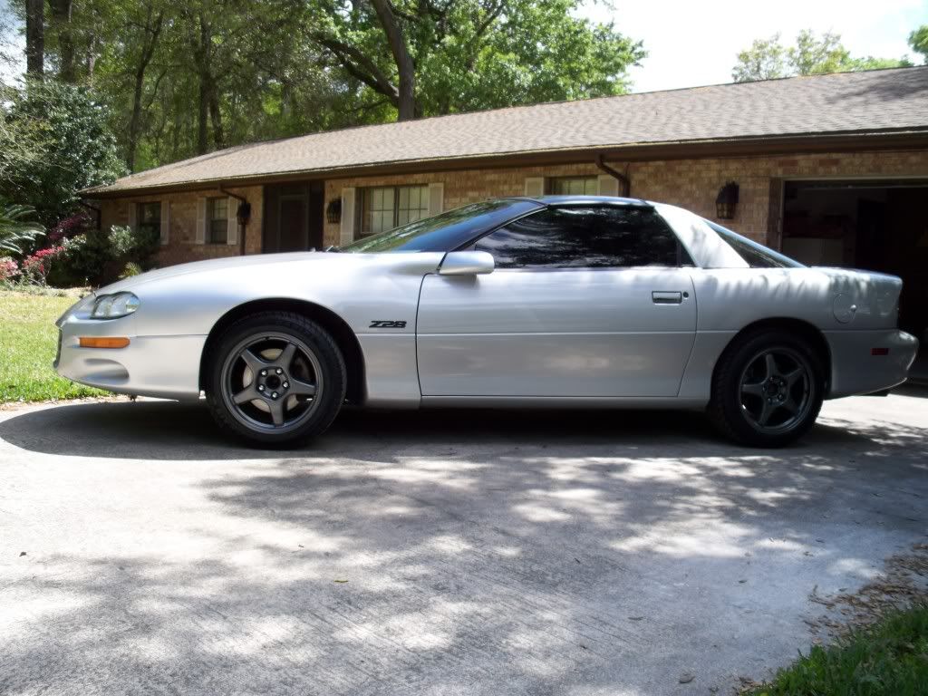

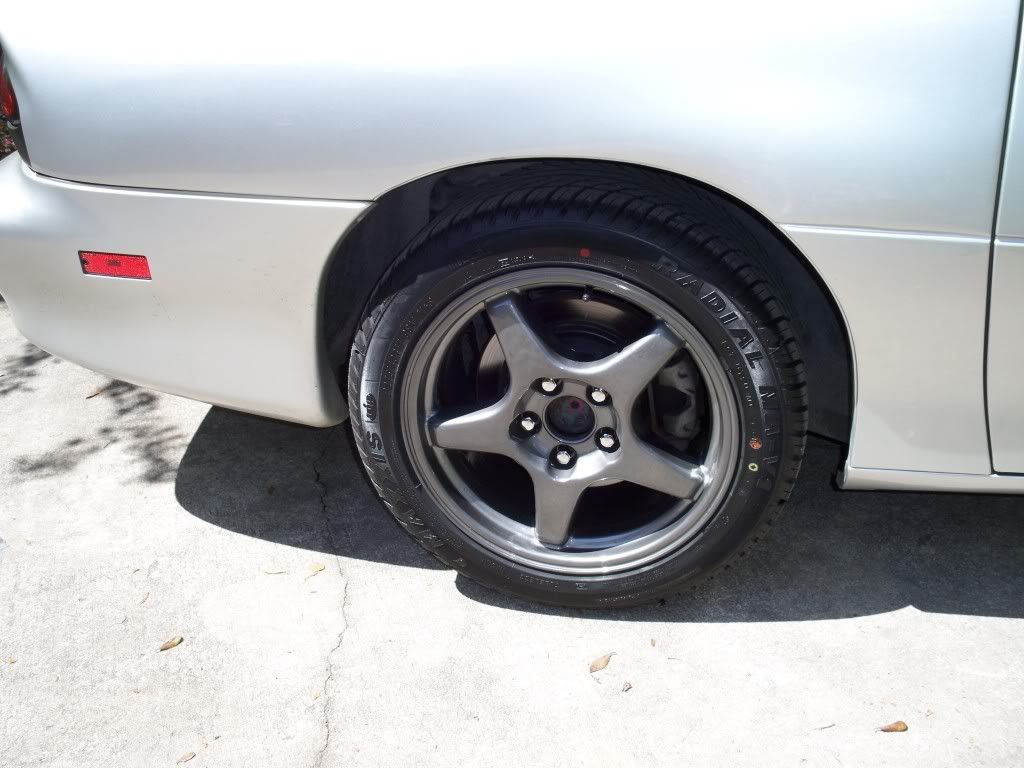

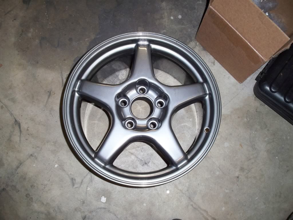

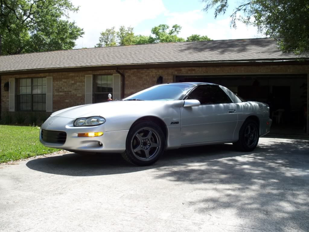

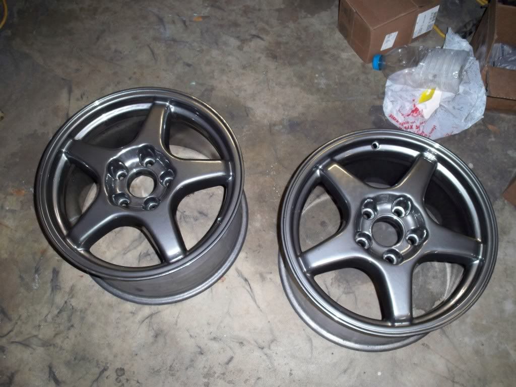

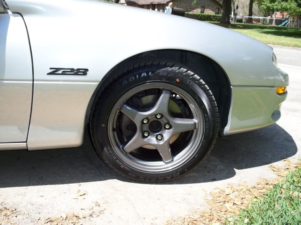

UPDATE:
Didn't like the color....was too light of a shade of gray for me. Redid them in Black Chrome.
Ok, almost pulled an all-nighter last night to get the wheels done in time to get some new tires today. Worked hard, but I'm very pleased. This black chrome comes out just like a nice gunmetal color, and has a nice, shiny and almost chrome shine to it when in the sunlight. Here are the pics!
