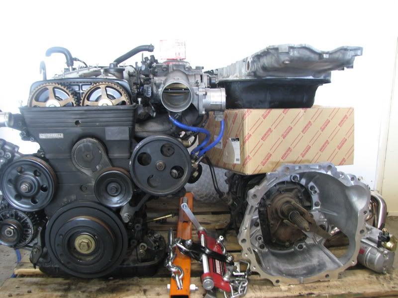

check my thread :) i explain or at least show most of this
you can tell thats an oil pan upper and lower. the 2jz has a front sump and i have a rear sump from a 1jz sitting there. an mkiv like yours has a mid sump and should work fine as well
