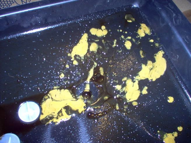

ok, im not sure if my head gasket is blown or not. i drained my oil out tonight and its just oil, no milky looking crap and stuff. i drove it yesterday.
it idled wierd still and it smokes at idle...
i took my afm off and its all oily on the inside kinda, there was some oil on the inside of the turbo where the accordian hose connects. oily residue in my intercooler pipes.
i have some pics....not good ones...
i have a homemade catch can it just goes from the valve covers to a can but when my car is running air comes out of it and when i open my oil cap smoke kinda comes out.
when i emptied the catch can there was water and some nasty shit...
