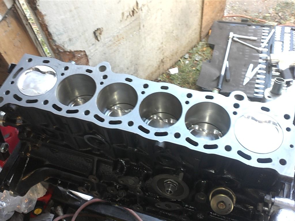

I just popped the pistons in the block last weekend. The rods are shot-peened stock. There are pics in the 'what did you do...' thread. Haven't finished assembly yet. Sure look pretty though.
(Edit: Added photo)
