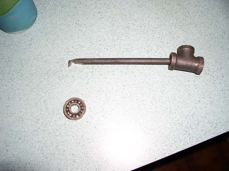

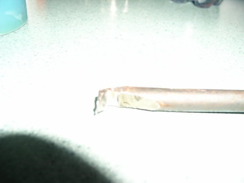

When I did my clutch I had to make a puller. I ended up getting the slide hammer and I made an attachment with a lag bolt that a ground down and connected it with some pluming parts. I might have some pics lying around. I will see it I can put them up.
