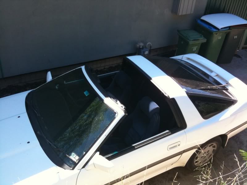

Its a Ma71 widebody Targa top.

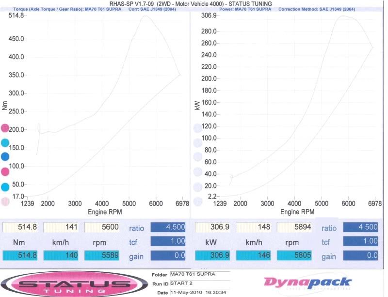

so far 411.5rwhp @ 16psi

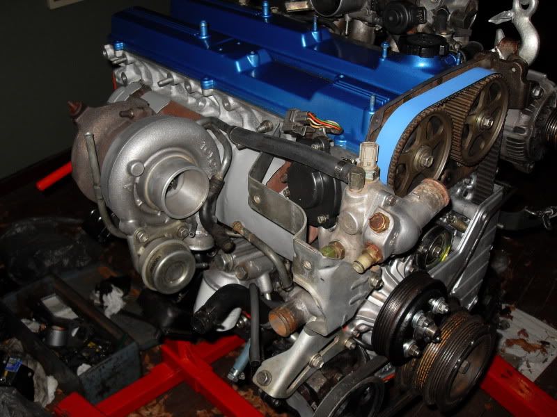

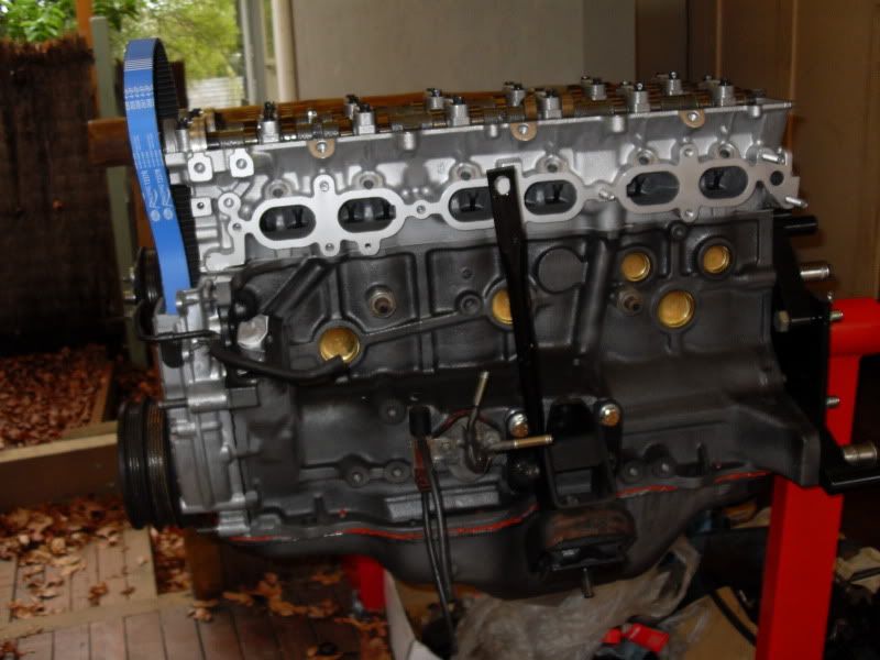

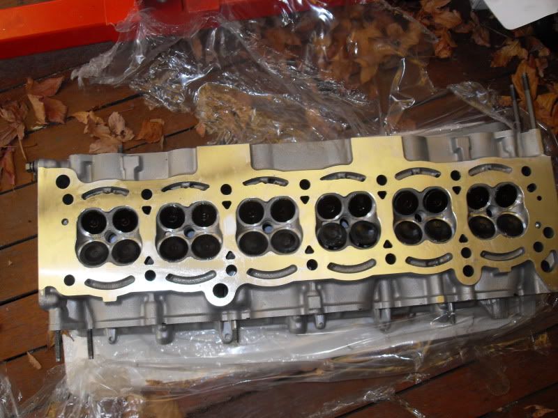

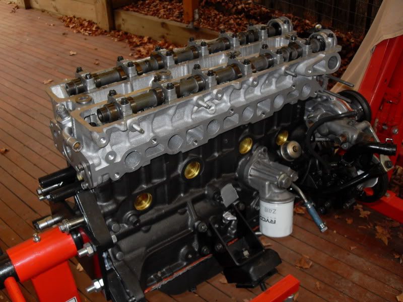

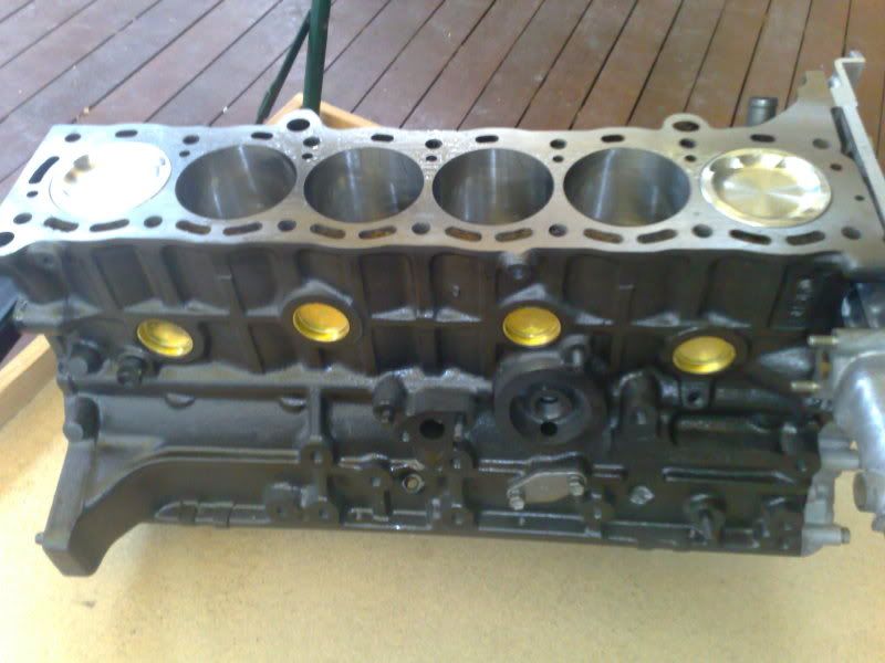

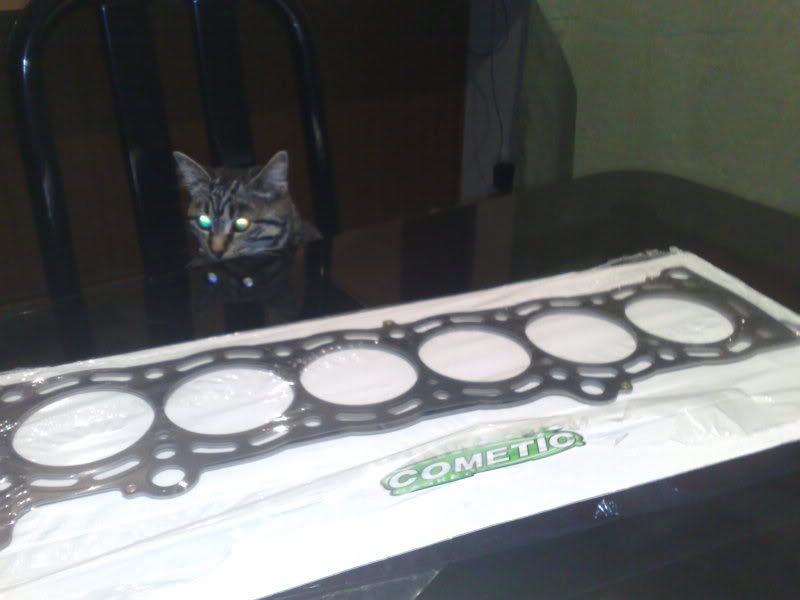

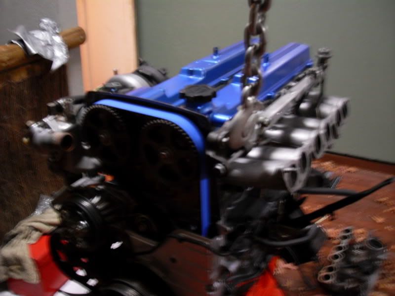

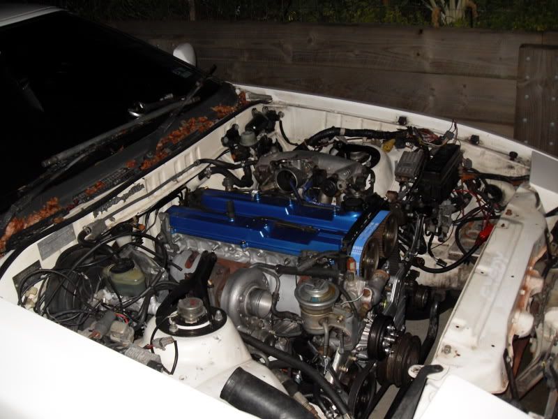

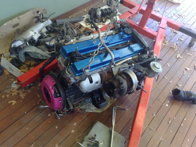

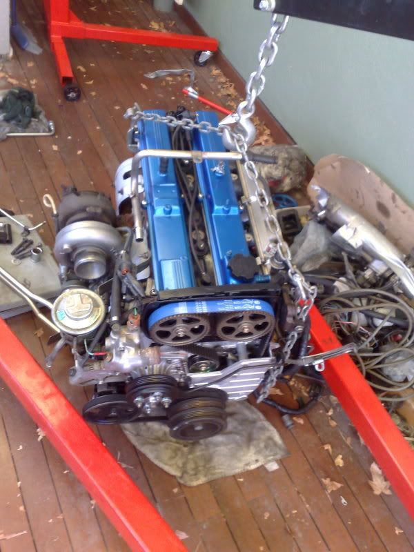

Engine:
7mgte complete rebuilt
ARP fastners (bottom end and top end)
74thou Cometic MLS headgasket
new stock pistons
stock rods
3 angle valve grind
reshimmed head
fully balance incl flywheel and pressure plate
block and head decked to RA spec etc
gates racing timing belt
Mostly standard stuff, every component inspected and replaced if necessary.

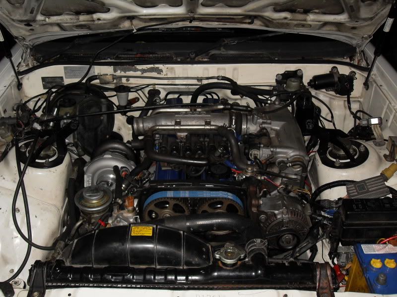

Turbo:

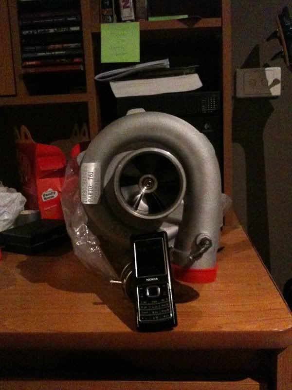

cx racing T61 bolt on
See: http://www.supramania.com/forums/sh...lt-on-Turbo-by-Cx-Racing&highlight=turbo+bolt
3" custom turbo back exhaust with a divorced down pipe
Gizzmo electronic boost controller
Fuel & Engine Management:
Haltech e6x w/ internal 2.5bar map sensor

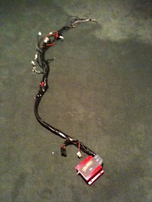

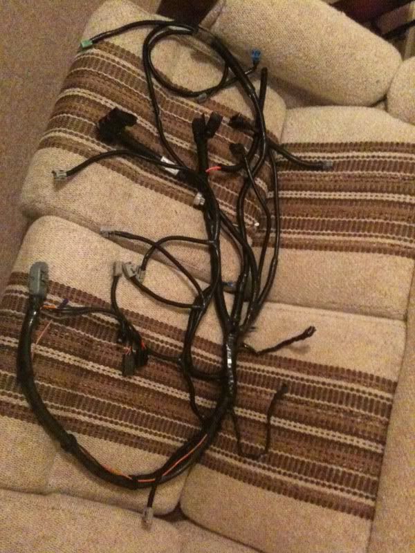

Completly new wiring loom
835cc Injectors
Single Walbro GSS341 255lph pump
Driveline & suspension:
R154
Os Giken TS2CD twin plate
4.3-4.5 diff gears... with a LSD, haven't cracked it open yet to take a look.

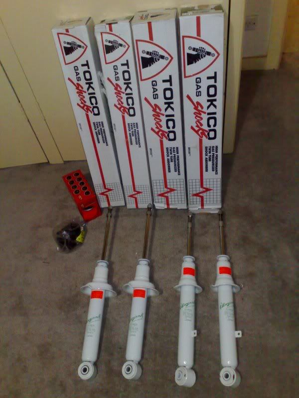

Tokico Illumia TEMS shocks... ill wire them into the haltech and set up a cracker suspension system.

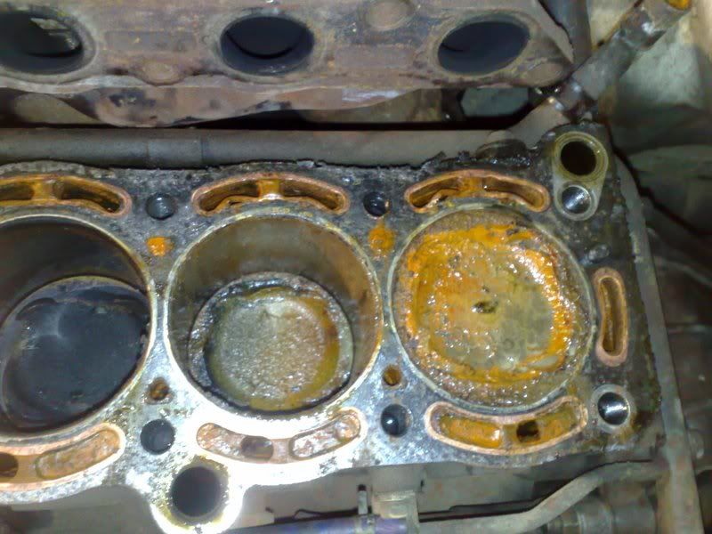

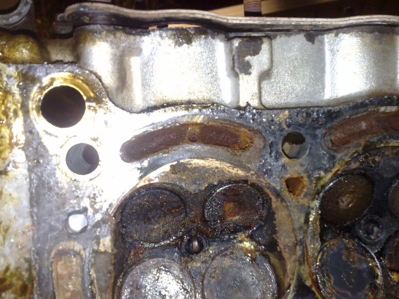

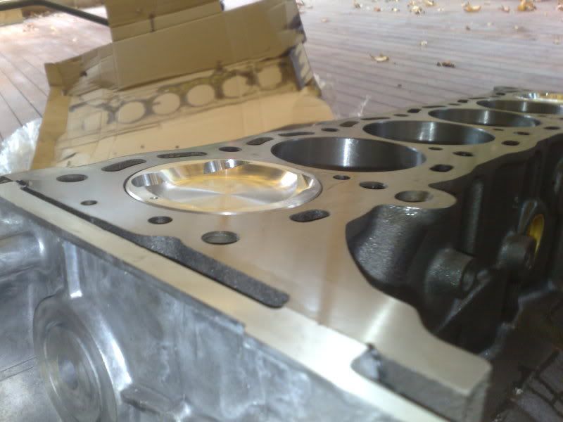

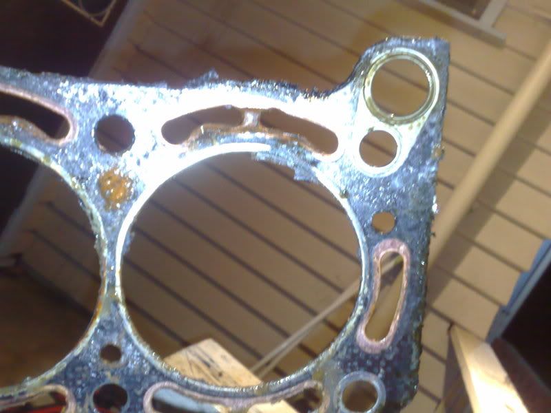

Blown between cylinders because i didn't deck the block for the MHG...

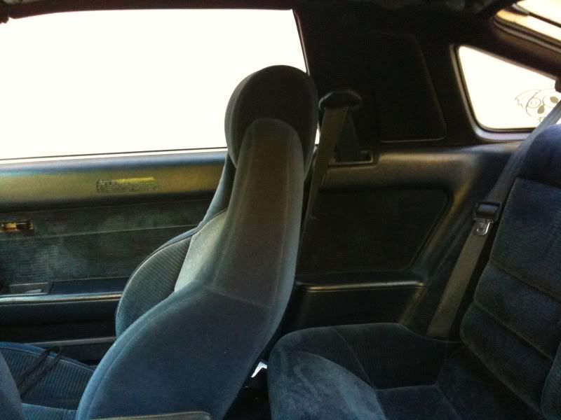

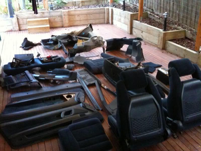

Interior swap, Red to Blue

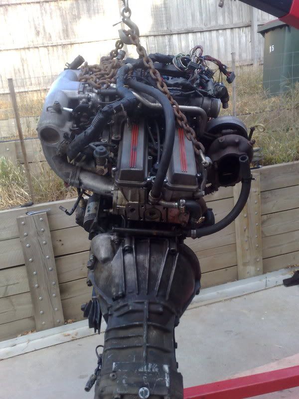

Get some current pics up as well. Almost everything looks good. But, I wouldn't blame the slipping on the clutch. You have too much for a W58 tranny to handle. Get a R-154 as soon as you can. Also, there is no 4.5 gearing in the stock Supra diff, unless it's different across the pond from us.

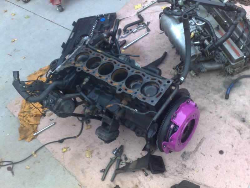

Currently i am about to remove the W58, im running a 225mm flywheel and clutch, it is too much for the trans to handle yes... im saving/searching for a R154 and a new clutch.
Speaking to a clutch builder here in Australia who "apparently" used to build the clutch's for the A70 race cars back in the day he said the 225mm clutchs are the same as in the tarago.. apparently the clamping load isnt increased much by exedy and as a result they wont hold, on the dyno its fine (dyna pac) but trying to push a 1500kg car is a diffrent story. It was making about 250-260rwkw @ 12psi and it JUST holds that.
i said 4.3-4.5 need to work it out but i struggle to get over 200km/h
cars still in the build process :)

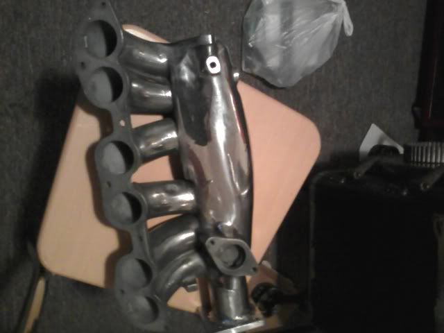

It's all back in one piece now, planning to completely redo the intercooler piping, fit my FFIM and change gearboxes

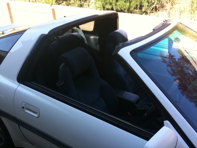

BrandonW
Jun 25, 2007
1,300
N.J.
looks good, i like the color of the valve covers
but switching from the maroon int to the blue?:thumbsdow haha j/k

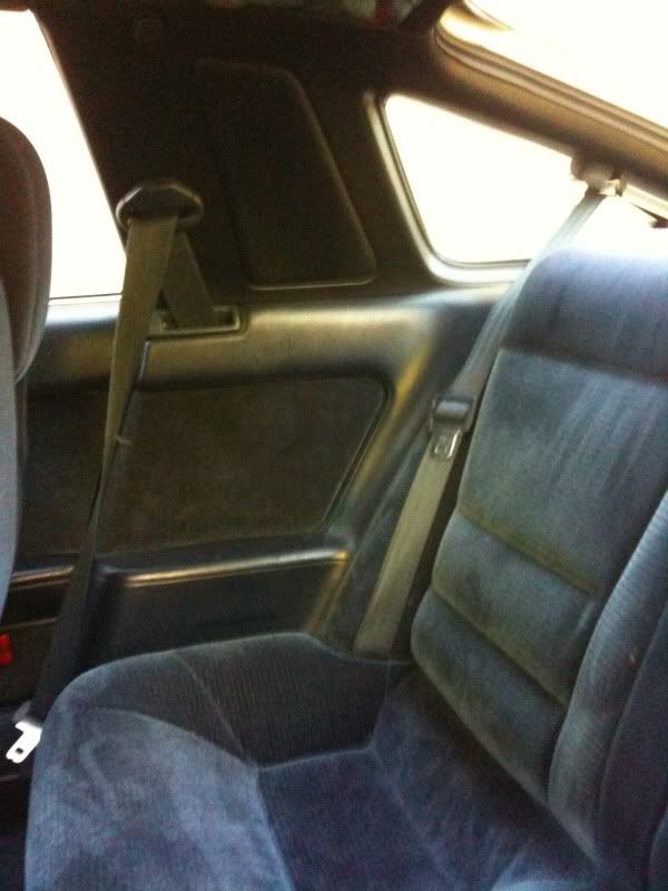

paradox616
Sep 12, 2008
472
Melbourne, Australia
happen to have any of the maroon int left?
Cheers, it came out nice i think. it needs to be redone...
Yeha i've still got the entire interior sitting in a storage shed, i used a vinal dye for most of the roof sections as i didnt get a targa top blue interior, i decided to get creative came out awesome! i'm a fan of dark roof lining, i figure the top half isnt touched often so the vinal dye shouldn't wear off its hard to get photo's
Still got all the blue panels spare anyway.

The last thing i need to fix up for my haltech install is the idle valve, when i've got a better gearbox & clutch i might hook up antilag for track use, it can also function as a 2step. not sure what ill use yet.

how do you like the shocks so far?
a member here was selling them with some lowering springs i was tempted to get them since everything was brand new
paradox616
Sep 12, 2008
472
the shocks are good, i will admit they could be a bit harder under the "sport/normal driving" but i think it has a bit to do with springs, when they firm up the dampening rate is good, makes suprise speed humps alot easier to deal with and speed humps in general, i cant compare them against much, i had shagged OEM tems shocks, but i did use bstillens for a bit and i like the tems much better.
87mk111
Metal Head
Sep 29, 2009
481
akron/canton, ohio
I'm glad u started a build thread. Isaw your post in the t61 thread, so I was interested to see what else you had going on. The blue interior looks nice, its my second favorite choice for an interior, my first being the shadow grey. Anyway, good luck with the r154 swap.
paradox616
Sep 12, 2008
472
Cheers! yeah shadow grey in Australia is next to impossible to find, at first i didn't like blue all that much but i love it now especially with the two tone.

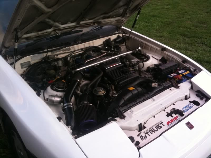

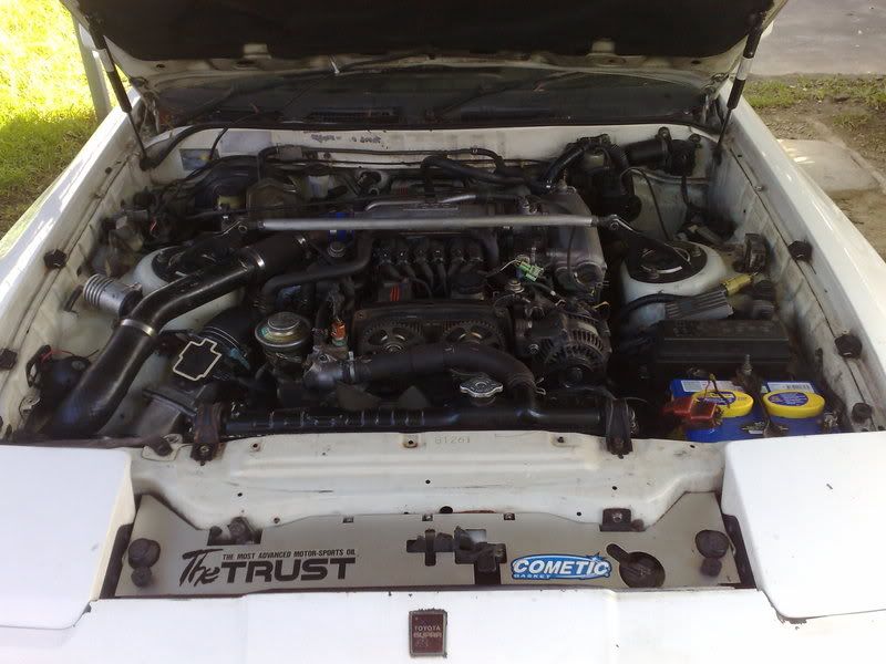

found 2 major boost leaks! on the factory ecu i had issues boosting above 9psi on a stock ct26, and 4-5 psi on the T61,
I got off my ass and made a boost leak detector using a few PVC caps, a few fittings a pressure regulator and a air compressor, added 5psi into the pipes and found 2 BIG leaks.. was seeing as high as 3psi drop @ 8psi (so really 5psi at throttle 8psi at turbo)
Dosn't affect AFR's at all on my Haltech but does affect spool.

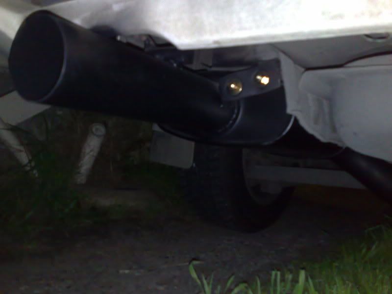

Whilst i wait for more funds to do the gearbox properly i decided to change my exhaust.
Currently i have a less than legal setup, 1 muffler all straight through with no cat. its loud (the wrong kind of) and smelly at times.
Ill be fitting a 3" cat and another muffler, its going to be loud on boost no matter what i do.. its the off boost stuff that pisses me off.

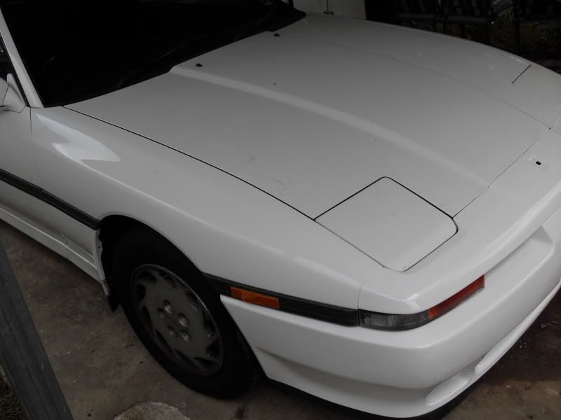

slightly_red_MA70
Holy S*** I own a Racecar
Jan 24, 2009
417
Canada

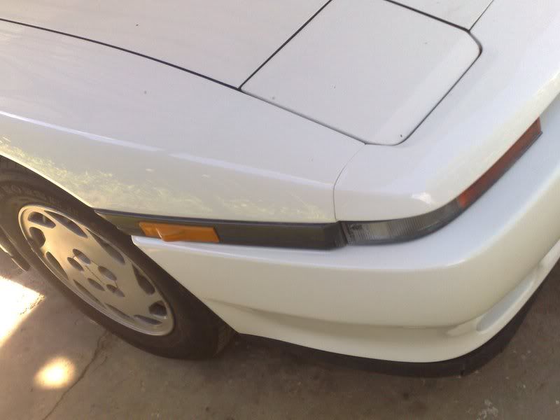

Someone had said before somewhere that theyre supra was a widebody the same as you did. Sorry if I seem stupid or whatever lol but mine looks the same as yours...was there actualy a widebody made from factory?
paradox616
Sep 12, 2008
472

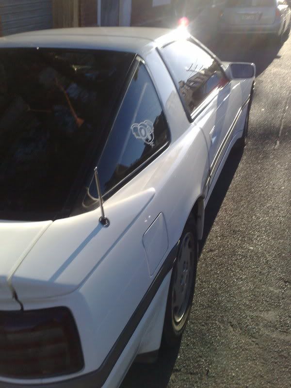

yes there was, most are wide body from what i can tell.
See this photo, Yellow is wide body, white is narrow body.
http://www.supra.co.nz/bodydiff/narrowbody.jpg
IJ. If noise = speed then yes, should be fixed soon enough :D
