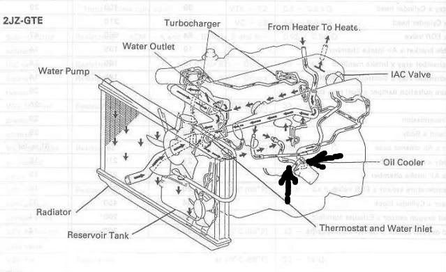

coolant is in fact suppose to be in those hoses...i have arrows pointing to it

The oil cooler does have coolent lines but that doesnt negate you having milky oil on your valve cover cap. You need to do a compression test on all cylinders.
ohh i didn't know that, but the reason that may have started leaking is because of the added pressure in the system from the exhaust gasses and the coolant getting burned off allowing the coolant to boil, or they were leaking and you didn't know which from the loss of coolant let your engine overheat and bhg
