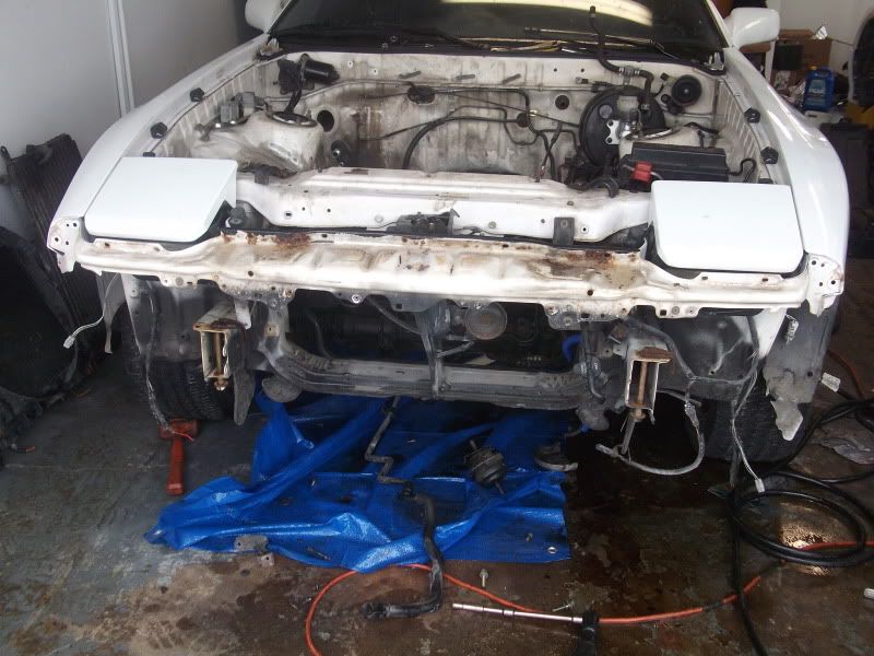

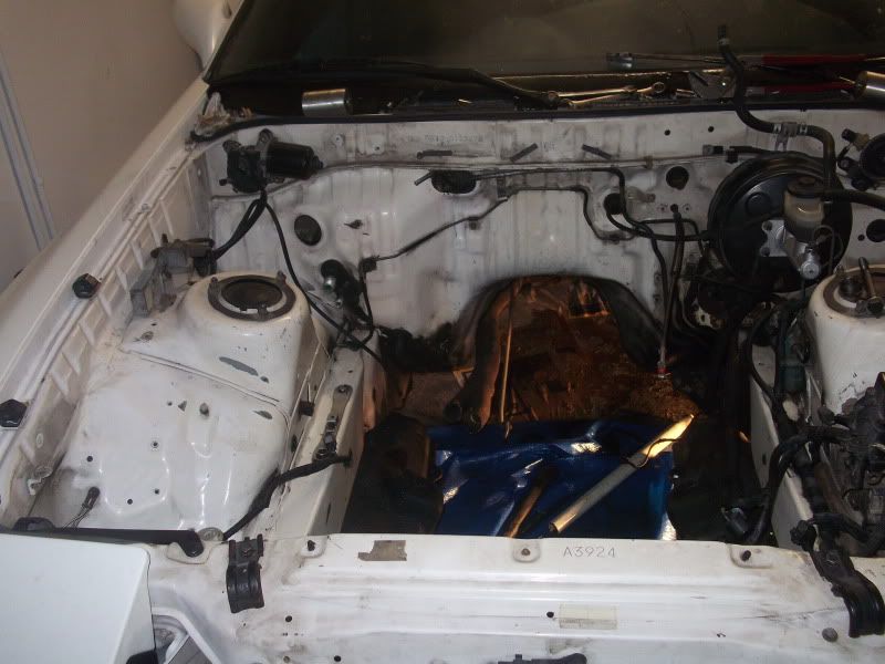

Front bumper and nose piece off
Taking apart the 7M to get ready to pull it out
And say bye bye to slownonturboautopieceofcrap cough* :nervous:

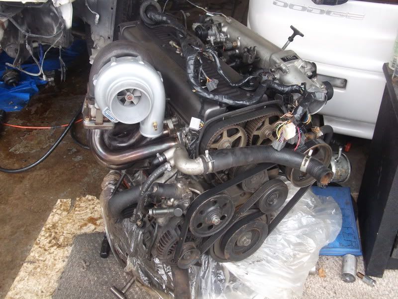

Say hello to the 1J

Unbolted the front bumper support to make it easier to get rid of all the A/C system.

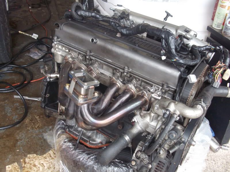

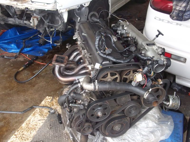

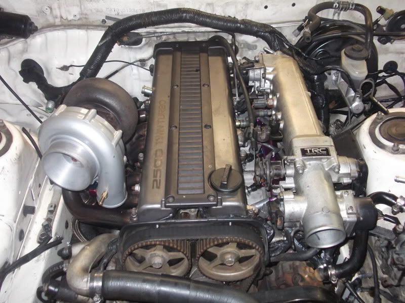

Now for the goodies, installed Ex. Manifold
I was surprised at the great quality with this t3/t4 adapter and sure as hell looks nice!

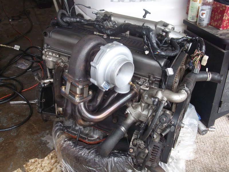

Mock up of the turbo before install

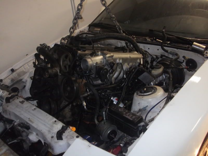

Bolted up the auto transmission, and swapped all the linkage/ speedo from the old 7m auto to the 1j auto

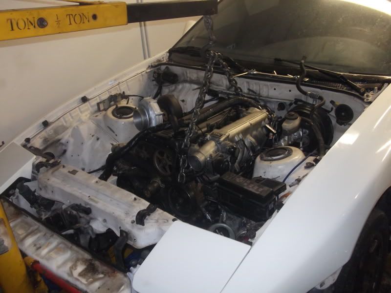

Getting ready to drop it in !
Almost!!

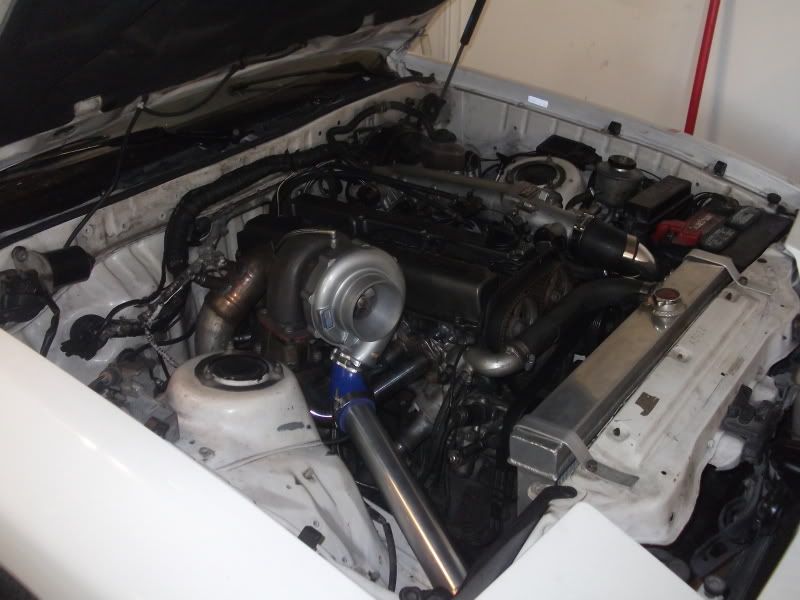

Ahh here we go, that's much better better.

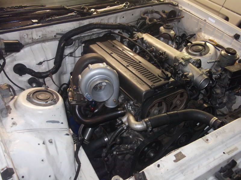

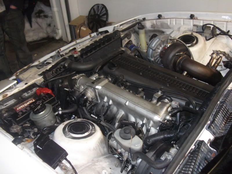

Rewired the harness and tucked it real nice. Test fitted the turbo and clears the hood. still have to clock it and run piping.
Minor things to do left before we start her up!
Should have it done by tomorrow night, turbo should spool pretty good on this setup!

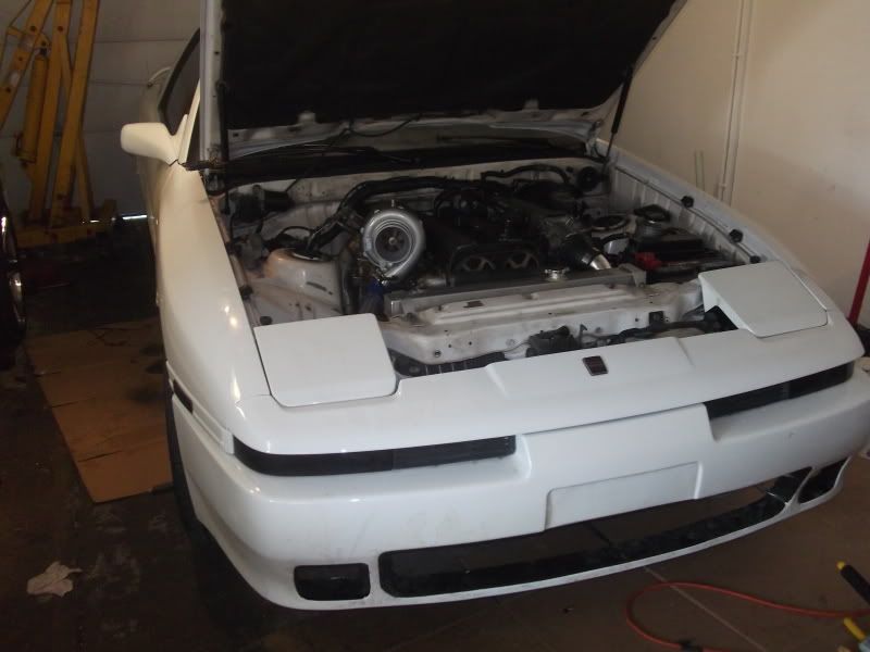

Ok finally got around to some pics,
Car is done, starts up and drives. Having some missfiring issues though, and the trans must be manually shifted (example, Must start in L then shift up to 2 then D) If im at a stop and keep it in D, the car stays in 4th gear and moves very slow.
Im assuming its wiring, if anyone has any ideas please let me know.

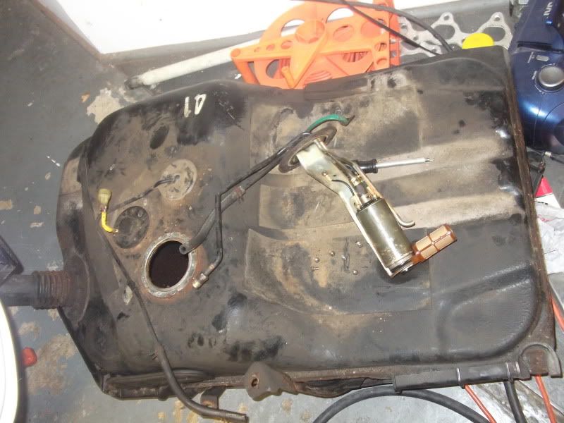

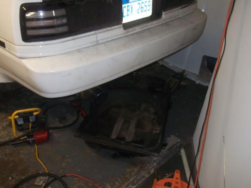

Took the fuel tank out, and installed a walbro 255

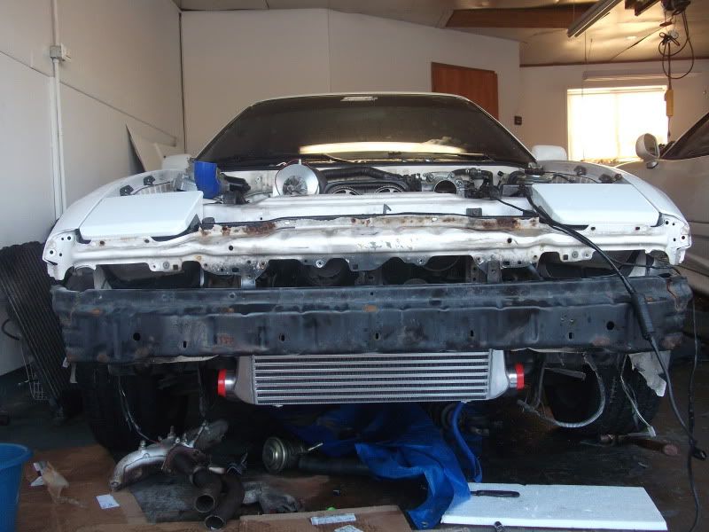

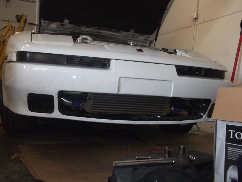

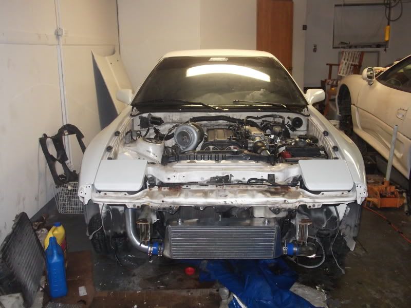

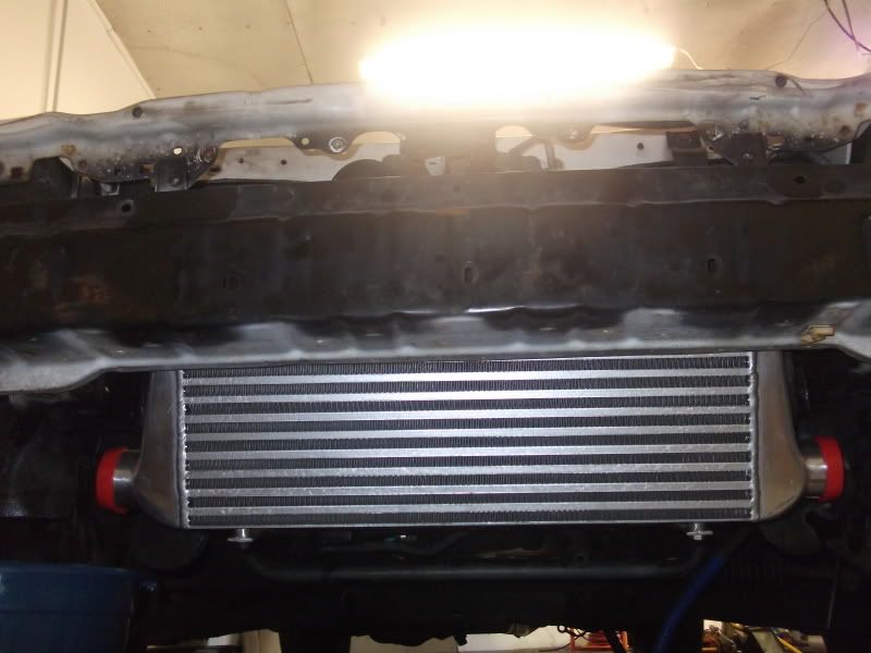

Got the intercooler mounted up and pipes ran.
final pic
I do have the hood/bumper on also , but car needs a wash so will take new ones tomorrow.
