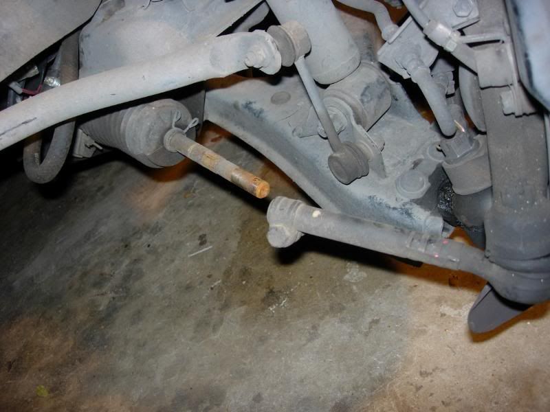

Hey guys! Just signed up, purchased a 1990 mk3 turbo targa 5 months ago and have been steadily putting money into it to get it to the point of being an eventual daily drifter and all around hate fueled domination machine. Right now pushing a reliable 300 horsepower & torque at 18 lbs boost. lots of induction/ engine/ trans/ clutch/ exhaust mods as well as full HSD coilover suspension and some other bits and pieces. My first question is this: steering angle. Other than putting the rack spacers on the inner tie rods, there aren't many effective mods that will make the angle go from night to day. I can't seem to find any inner tie rods that offer extra threading. I could reposition the spindle on the knuckle/hub but really, that's the last step in the process as i see it, it being a fairly extreme change to the OEM steering geometry. I've seen a few threads on angle but nothing that seems to take it into the realm of the extreme. Anyway, I'm looking forward to contributing here & making an ass of myself.

Welcome. If you run the spacers you will always be toed out so its not ideal for the streets. You can adjust the bump stops out more.

Thanks for the reply! Wouldn't I be able to make adjustment for toe out by adjusting the outer tie rod inwards?
"Thread the inner tie rod end back into the outer tie rod and adjust the toe angle. (I applied a small amount of WD40 to the tie rod adjusting threads to help prevent them from rusting stuck in the future.) While making sure the steering wheel stays straight, line the front wheels up with the rear. This gets the alignment close enough for a test drive to better adjust it yourself or to take it to a shop."
