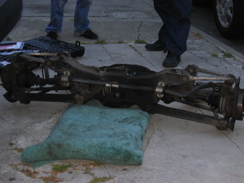

I woke up today and some fucker stole my whole rear end overnight...
sike!

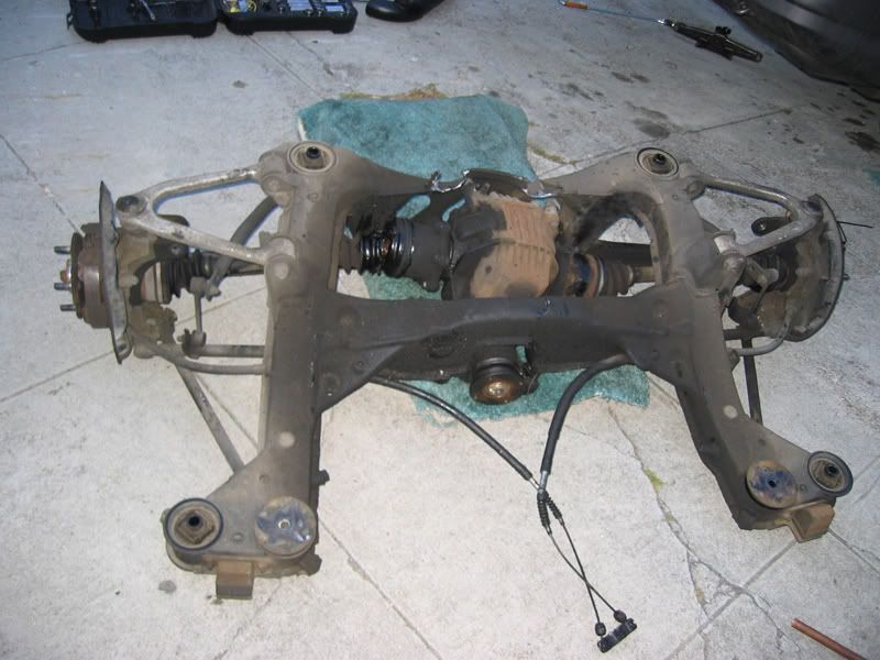

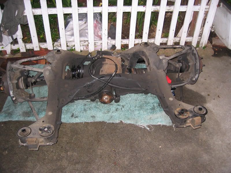

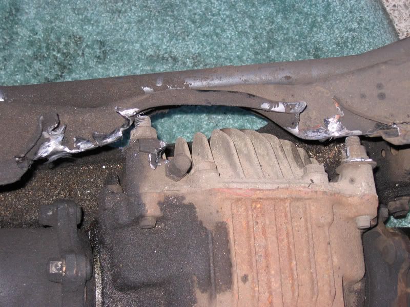

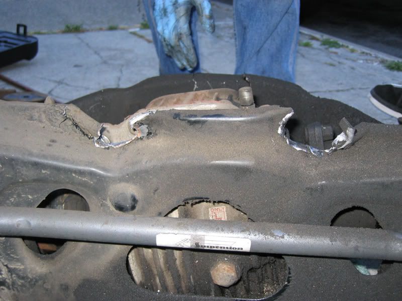

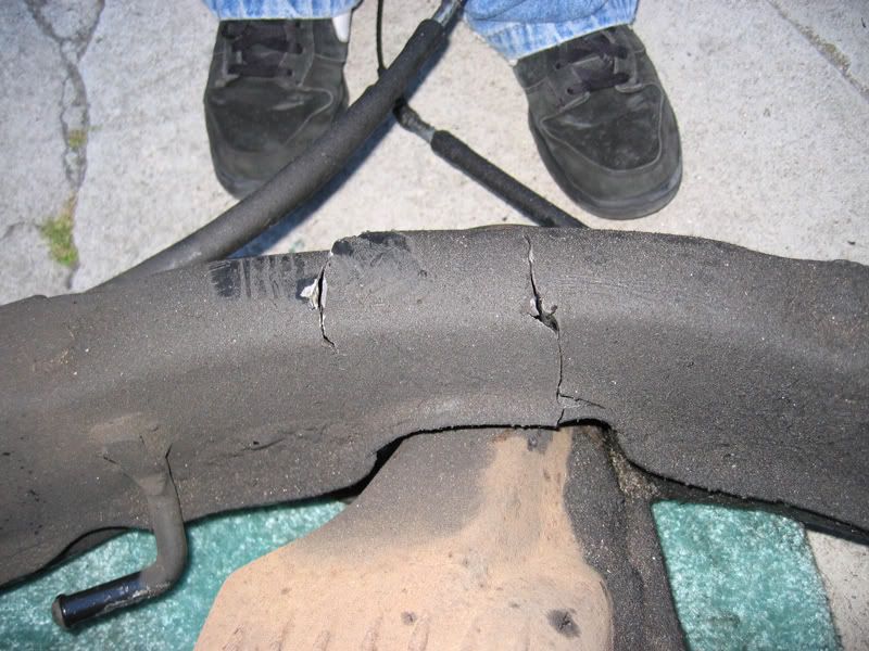

you can see here that the bolt on the left side of the differential broke off, but that's just one part of it

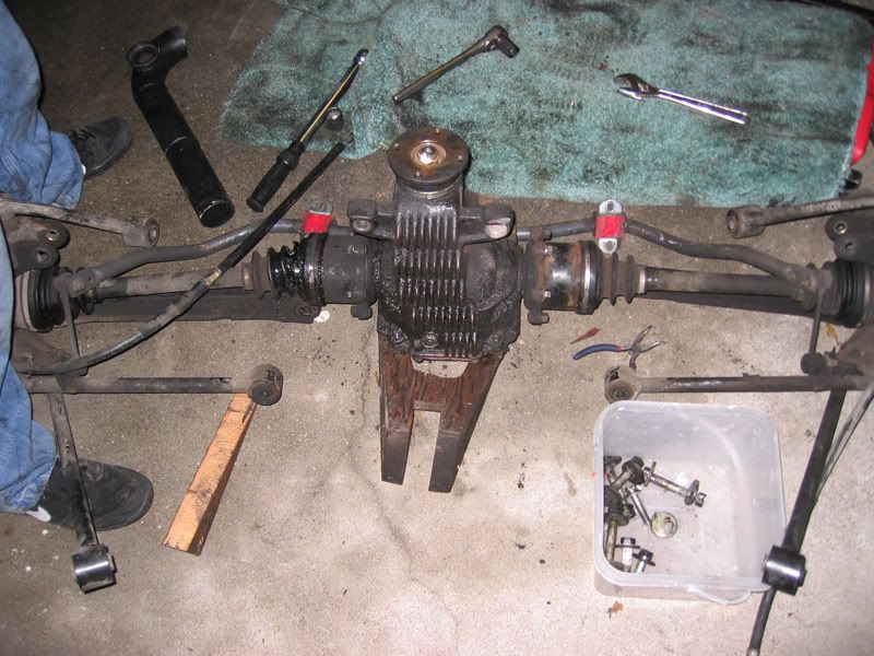

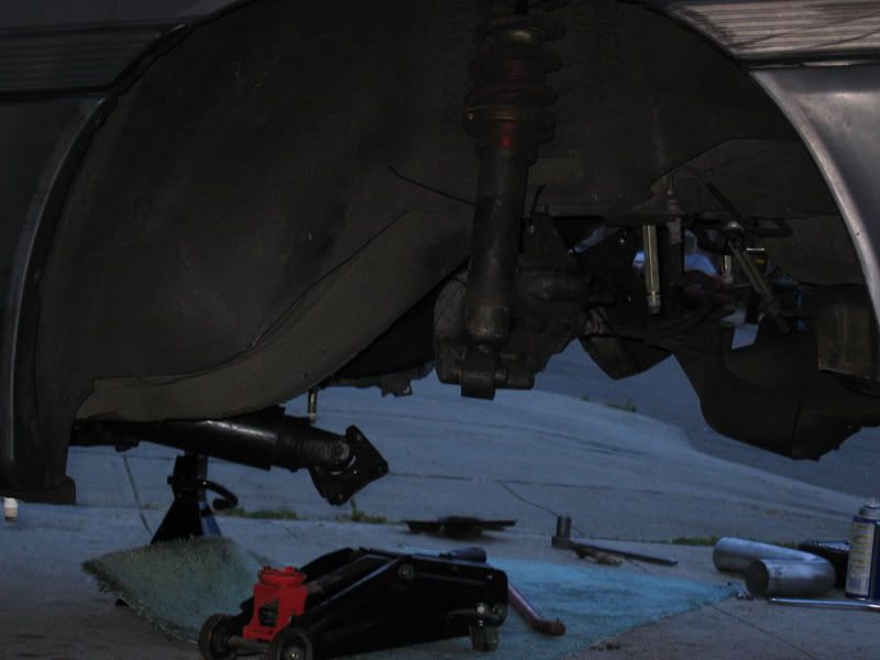

take of the tires and caliper and hang it somewhere then take the bolt out of the damper
take out the bolts off the differential, it's a pain in the ass, easy way I found it was just put it in gear and crank it for a second to rotate it around
didn't take a picture of it, but then you just find the e-brake cable above the driveshaft and disconnect that then you're ready to remove your subframe
