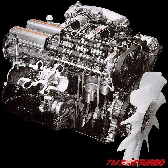

a little off topic but do you have the high res of the pic in your avatar :)

Sabotage here's that pic you wanted:

mm now thats sexy, time for it to go into a few signatures :)
