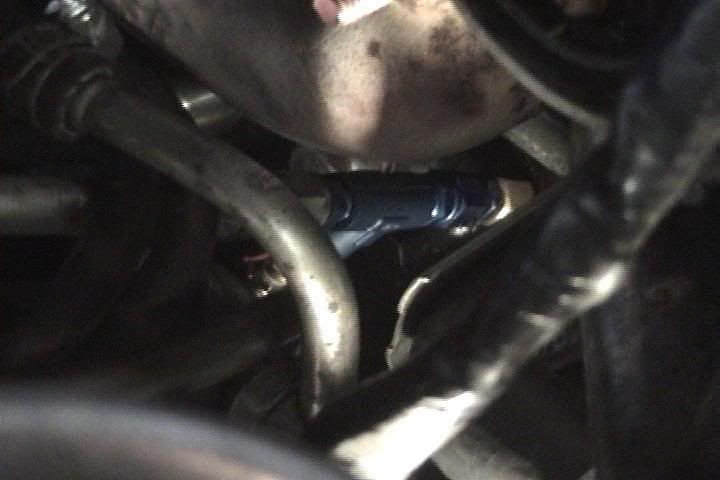

heres where the sender is at

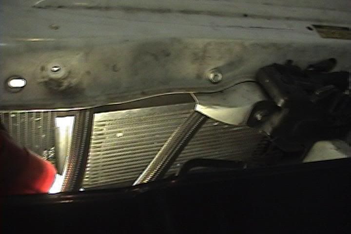

and this is the location of the cooler

In the pic, it looks like the temp sensor is right below the exhaust manifold...is that correct? If it is, there's an awful lot of radiant heat in that location...might be throwing the sensor off ;)

im thinking also i dont have a fan shround currently or a under panel, and the oil cooler is practically right behind the bumber support. and some times when i acclerate it pops very fast and theres power loss.

I thought the same thing about the sensor location. I would measure the temp at the pan, filter or cooler before I put it there. Routing should have little effect, since he's not running a t-stat, although I would suggest plummbing one in so the oil has a chance to warm up, if the exhaust is influencing the readings.
Ours is routed from the engine to the filter, from the filter to the t-stat, from the t-stat to the cooler, from the cooler back to the t-stat and from the t-stat back to the engine. Idealy, the t-stat would be a good spot to put the sensor, since the temperature would be an effective average of pre and post cooled oil.

yea the colants fine, koyo rad with 16 lb cap w/o fan shroud, yea the sender is close to the exh mani, that could be it will mess around with the car tommorrow, thanks everyone for the support. :)

The oil cooler needs to be in the air flow to do it's job. Any radiator type cooler needs to use the air stream or a fan...otherwise, it will loose effectiveness.
