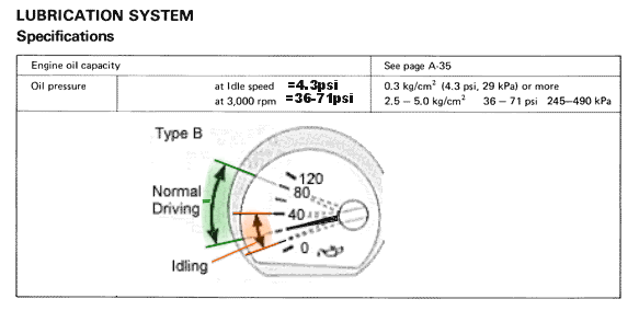

Spec at hot idle is around approximately 4.5 psi. So 20psi at hot idle is pretty good. Sounds like you have a shimmed pump to me. Oh but I hope you're not getting your readings from the stock Oil Press. gauge...It's not very accurate.

Stock gauge IS accurate, it just doesn't have as many lines to tell exactly what the pressure is and it's dampened so it doesn't react as fast...

Yeah, on the stock gauge, I get ~20psi at warm idle and about ~45psi at anything above about 1500RPM. So that sounds normal. I thought it was low, too, until I saw the TSRM, which basically says any oil pressure is a good thing...
