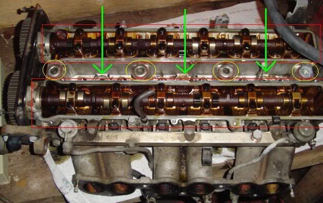

I read http://www.toyota-supra.info/forums/mkiii-supra/7527-got-oil-on-top-of-your-spark-plugs.html after finding large quantities of oil on my #1 and #2 cylinder spark plugs when I was pulling them yesterday and decided to get rid of the #3 cylinder head cover and convert the hex bolts into using a simple oil drain plug gasket.
I was wondering if anyone has done this and what size oil drain plug gasket were used. The reason I am asking this instead of going to size up the bolts with the plugs at the auto store is I want to order them before I do the conversion to save some time. Motor is a 7MGE but I am assuming the bolts are the same size as the GTE model as well. Thank You-
