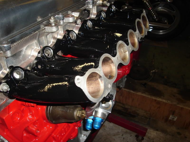

if you want to do it directly off the block,you will need a very long 3/4-16 addapter.i pulled my cooler off and want to get rid of the housing also.i just haven't found the addapter yet.i'm using an earl's sandwich thermastat on mine.you can see it under the intake

does anyone have a good photo of where the cooler lines go to under the intake manifold? and would we just block them off when removing the stock cooler?

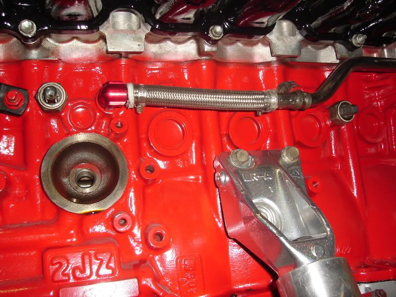

cnewingham said:
so what about the lines that came off the cooler that the filter attaches too?
you can just run the coolant line directly to the block from the coolant pipe going around the block.i'll post a pic of mine for ya.you can see how far the thread's for the oil filter go into the block in this pic also
