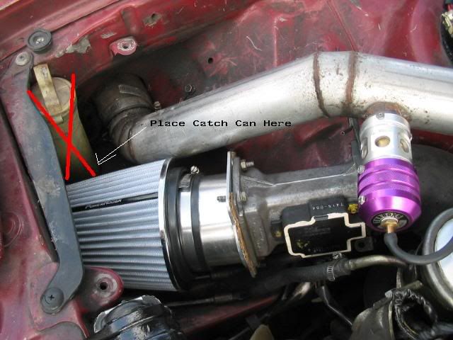

Hey shaeff, i got one for ya... You know the space between where the air filter is, and where the upper intercooler pipe enters the fender right? The spot where the neck for the washer fluid reservoir is right? How bout removing the reservoir and placing the catch can in that spot? Id imagine it should be in a cold spot on the motor right? And in my personal opinion, it should be less lines to run.
PLace it there would be a pain to route the hoses. I would rather somewhere closer to the Cam covers where they PCV pipes come out of.

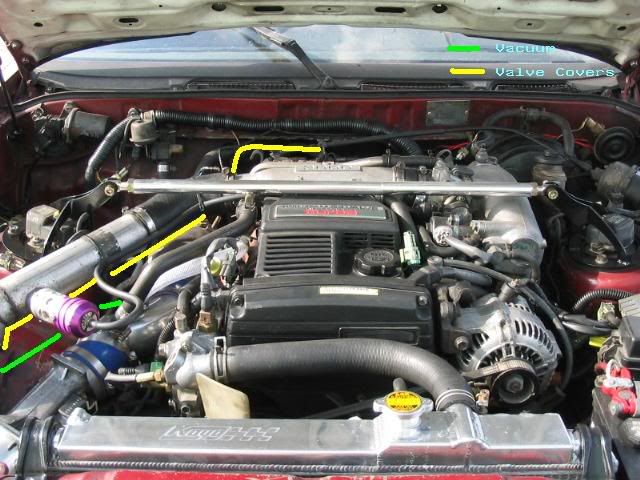

i tried to keep the lines located in cooler places as well, but as long as the can is in a cool place, you should be fine. :) that looks like it'll work well.
-shaeff
