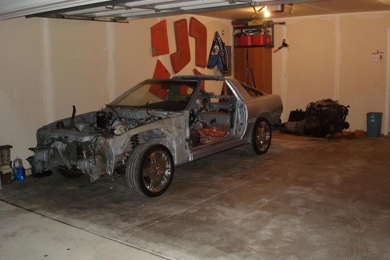

Just my two cents but if your going to change colors you may want to take the car down farther. Even for a basic respray I personally would pull all the trim, rear side windows, door handles, seals ect. As much as you think you wont have tape lines, you will. As far as changing colors go it really needs to come down almost to the shell. Your bay, jams, and the back sides of everything like hatch, hood, targa, fuel door ect will all be a different color. Also to have all this sprayed costs big $$$$!! Dont get me wrong you can just do the outside of the car but if you ever want to resell it you wont get what the car is worth. I personally would never buy a car that someone changed the color only on the outside. I am only changing the color of my car to a more current scion gay blue and this is where I have mine.
This picture was taken in the fall and I have since cleared the bay and I am getting ready to pull the dash as soon as it warms up. Since you are doing your own prep work here is a thread that may help. Good Luck!!
