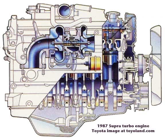

May be the dumbest question on earth, but im having a super brain fart moment. I want to get rid of the fan on the front of my engine 7mgte. Dont bash but I believe its called the "Fan Clutch"?? Its the fan that makes the car sound like a damn semi, if that helps.
I need to know what its called, and how the hell to get rid of it. Please and thank you!!!
Ive tried searching but its kinda hard to when your unsure of the part name. lol

We know what you're talking about. There's two parts, a fan and a fan clutch. The fan clutch is a viscous coupling that drives the fan at different speeds based on the temperature of air coming through the radiator. You should keep them...

Ive seen supras without them though. Now I know Im not being clear or Im not thinking of the right part.
And I worded my 1st post wrong, I dont want to get rid of it, I want to replace it. Sorry for that.
Its the part that is to the far right. I want the fan gone. I know it can be done, I've seen many supras without that fan.
Btw, the fan would get replace with 2 flexlite fans on the radiator.

I planned on that. I just want the fan attached to it gone. But everyone is saying it may overheat. I've heard from a few people that getting rid of the fan will free up a few hp. And in the process make the hideous looking fan go away.
