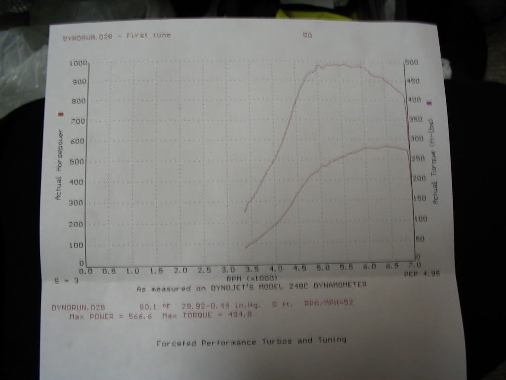

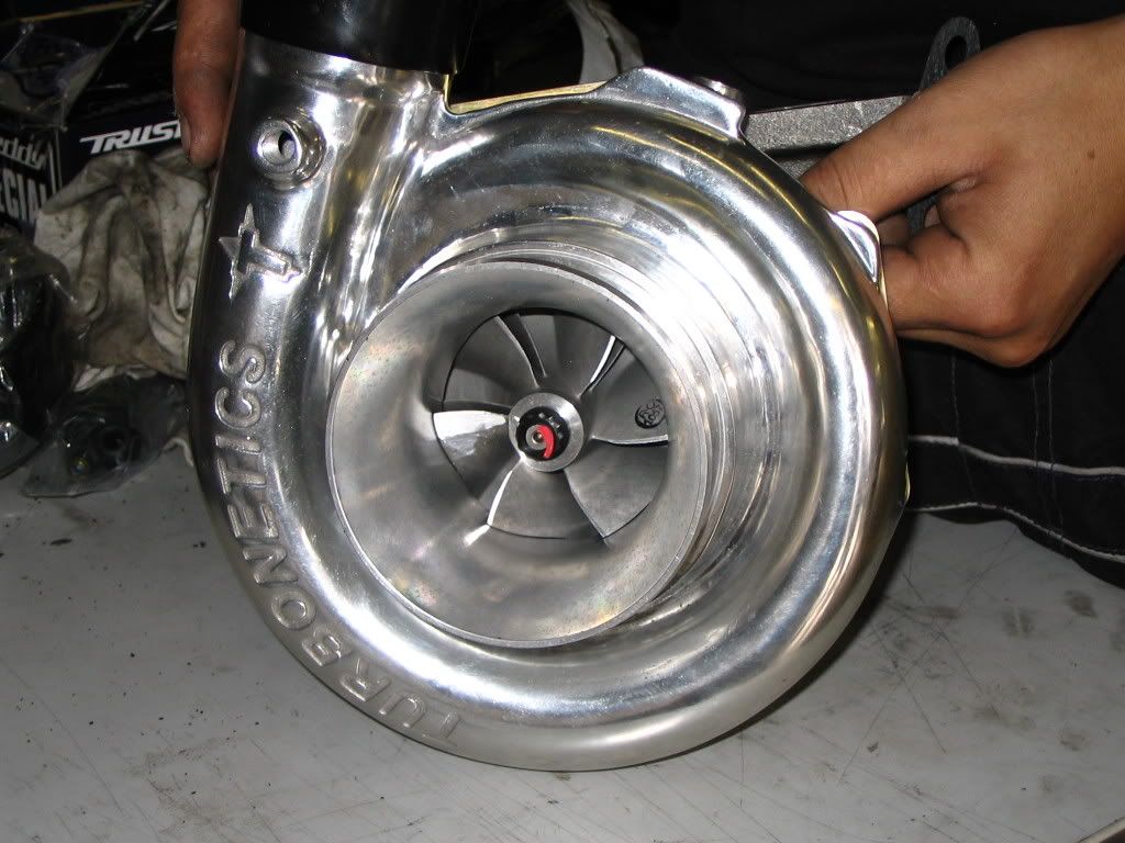

Loki said:Is this with the same turbo you were running at SupraFest? or did you change it already? anyways very nice numbers Don, I can't wait till I'm putting down that kind of power![]()
bluemax said:Were you using pump fuel?
VanSupra said:My dyno chart @ 18lbs of boost and C-16
Adjuster said:I would think with a turbo that large, and the intercooler size, C16 at 18psi was not needed. Just my opinion however. (It's safer, but your going to fry your O2 sensors with the lead.)
What boost level do you run on pump gas?
