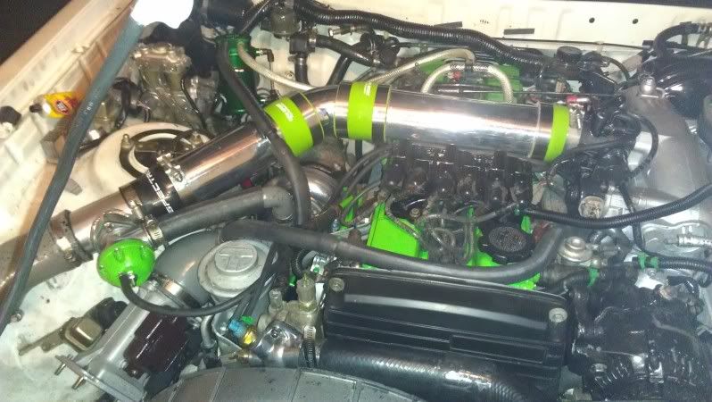

Rebuilt my turbo today. Painted some parts to make it look nice too.

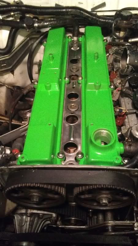

Didn't work on the head today, tackle that tomorrow. But did end up cleaning and painting the valve covers. Going to paint the block the same color...
