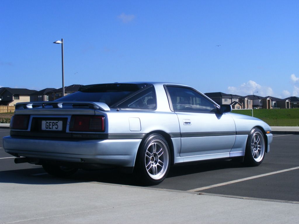

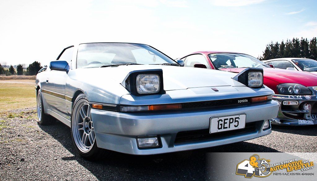

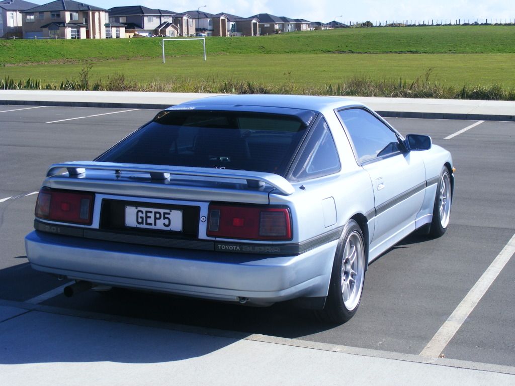

Here's my non-staggered set up: PICT0041.jpg245/45/16 BFG/KDW. They aren't adequate for the torque the Supra now makes. I'm planning on 17x9, Enkei RPF1 http://www.tirerack.com/wheels/enkei-racing-wheels.jsp with a near stock off-set and 255/40/17 tires. Van

cool keep them coming... That's exactly what I was thinking: 17x9 +24ish with 255s or 265s... good track set-up for better F/R balance and less understeer...

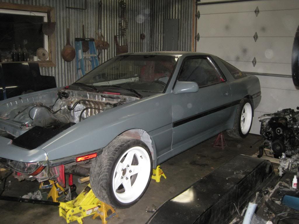

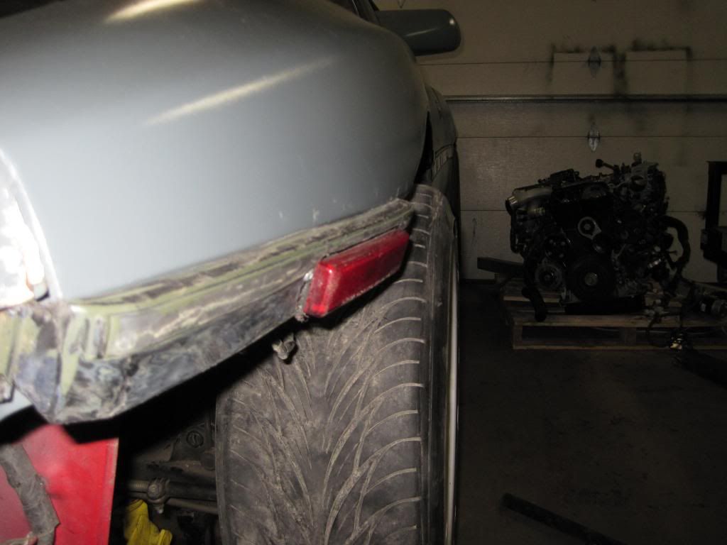

Here's my wheels I just got. 17x8 0 offset. Front tires are 205 and rear tires are 215. Obviously I will be modifying my fenders.

The answer to your question is steering angle increase. And I didn't modify my tires. ??? I just bought these wheels (that means tire and rim) off a guy who had them on his RX7.

I can't see how my wheel offset could effect my suspension travel and behavior. Having a wider stance would make my car more stable I would think... I have lowered my car with Stance coilovers and I know that the control arms are not ideal. But I have a fairly stiff setup and there is not a lot of movement compared to how it would be on original springs. I don't have any rear suspension arms yet but I plan to get some. That will allow me the adjustments needed to get a good drifting alignment. The only bad thing I thought there was from having zero offset wheels was that there would be more stress on the ball joints and knuckle areas. All my ball joints are new and ya, supra suspension is strong. Drifting is also a little bit about looks of the car. So lowering is a good way to go and it lowers the center of gravity so that helps increase handling ability. I want to do some playing with the sway bars too. Many grassroots drifters are ditching the sway bars but I don't really want that.

It sounds like you want a lot of meat. You need to think about turning the wheels also. Usually if there is issues with turning clearance the wheels hit the front sway bar and the lower control arm at or around full lock. Also the tires can move quite a bit just from hard cornering forces. In my picture I have pulled the rear a little bit. The front fenders I have not modified. You can see that the zero offset wheels in the back seem to fit better, where as the front ones stick out about a half inch. But I think I have pulled out the rear fenders about an inch or so. I am going to be widening my front fenders of course. Since nobody else is providing pictures you should go look at the other big wheels/offset threads. I hope my zero offset 17x8 rims picture helps you determine and take measurements of what you want.
