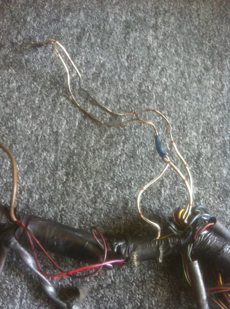

Yes all the grounds head to body battery to engine battery to body tranny to body harness under intake manifold coil packs buuuut i found one ground that was cut off you know how on the intake manifold it has two one white with black stripe nd brown spots and the other solid brown well the white ones had one that was cut off it doesnt look like its going to the ecu it goes away from it somewhere by the igniter plugs thats where it ends the ground wire

Yea i have that look

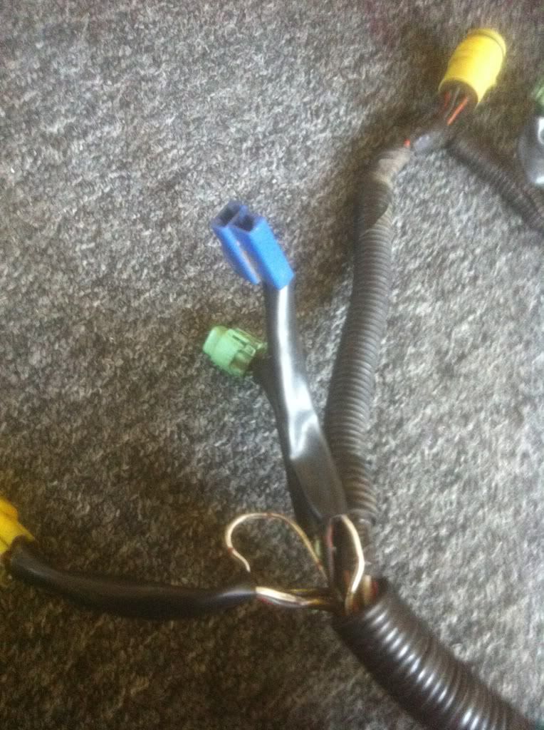

see those two ground wires those are good they have continuity at the ecu plug pins but the other one that seems to be going the other way ends up here at a blue plug
the thing is that this is my na harness and my turbo harness doesnt have that blue plug so i dont know where that ground goes

There should be 2 brown wires to go with the white wires that ground in the same spot on the intake.

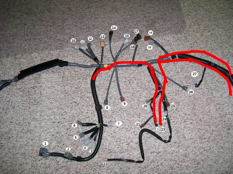

Lets try it like this
I understand the iirc ground wires bolt on to the intake manifold i have that bolted on . Heres my problem one of my white ground wires is cut off . See where the left red line ends thats around where mine is cut off i dont know where its attached too . The other ground wire that turns into two is fine check for continuity no shorts
Next im going to check if the ecu is getting power , also measure resistance between igt and igf wires, and then check power and ground at (B1+, B+, G, BATT)
