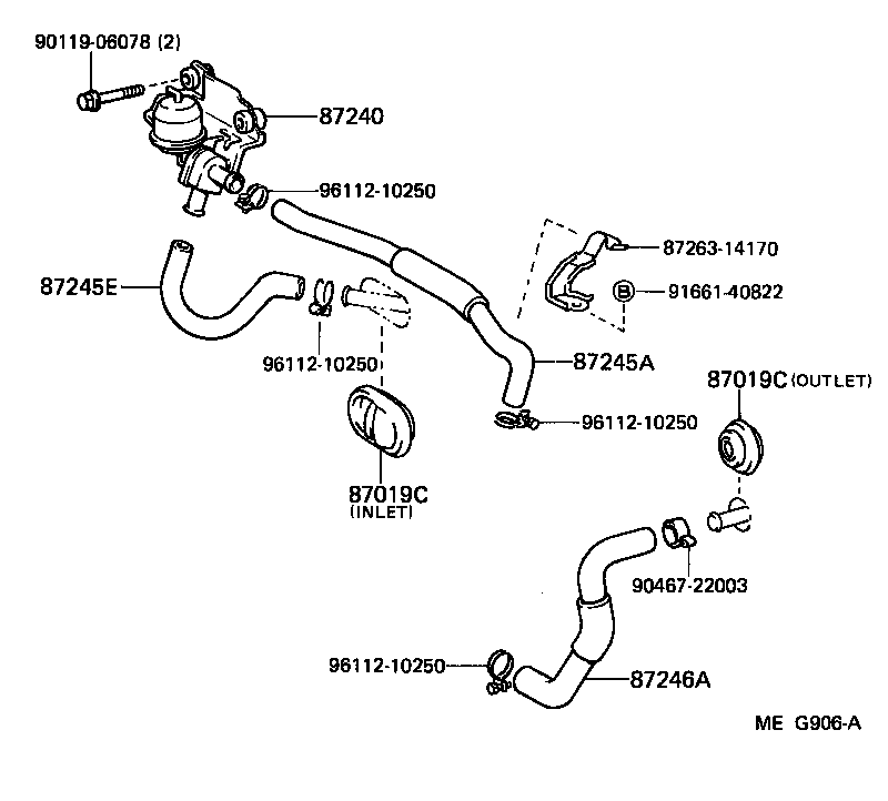

The water valve VSV is what they ate talking about, its attached to the heater control valve on the firwall and the passanger side
shaeff
Kurt is FTMFW x2!!!!
10,592
11
Around
heater valve- 87240
see the metal bar attached to the bottom of it? pull it up with the heat on high and the car running. it will allow coolant to pass through the heater core, thus giving you heat. if it won't stay up, check the vacuum line, and if it still won't stay up and the vac line is good, use a wire tie/ zip tie to hold it up until you can snag another from any of the various models of toyotas in junkyards.
-shaeff
