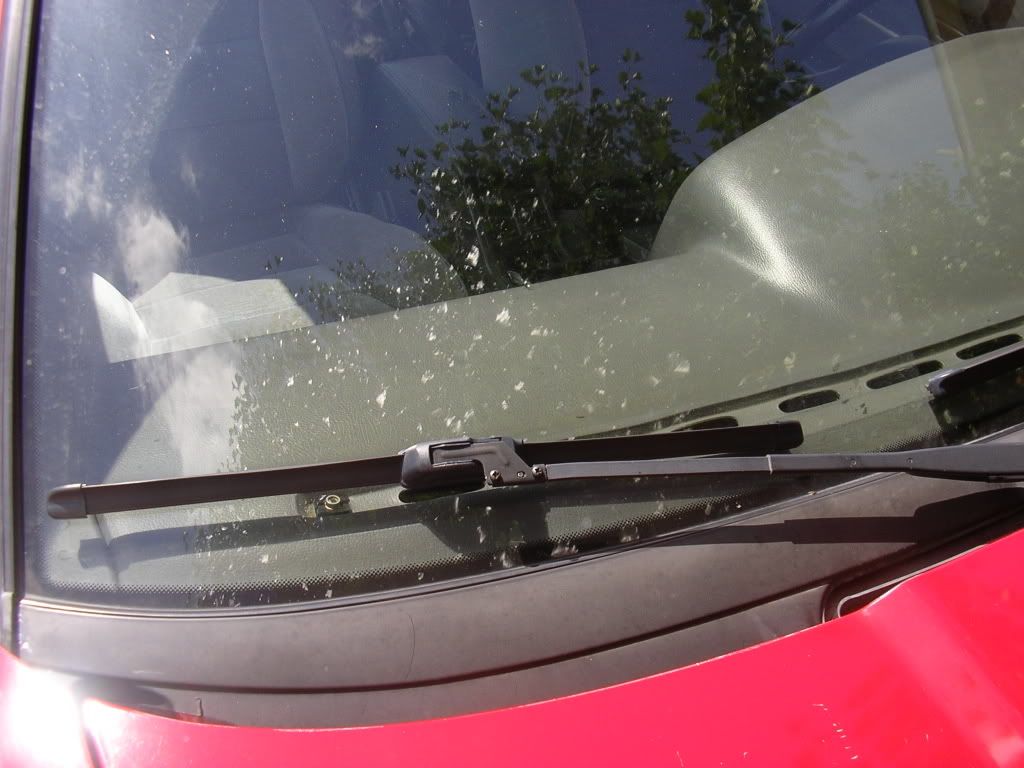

See that little gizmo under the wiper blade? If yours looks like that, that's your problem. It's the light sensor for the climate control, and it's supposed to have a smoked plastic cover over it. Without the cover it thinks the sun is really intense, so it compensates by blowing cold. 65 and 85 bypass all the automatic settings though, with full A/C or full heat respectively.

Would it act the same if the sensor were just not plugged in?
I ask because it worked last winter before I looped the heater lines and now after removing/replacing the dash it doesn't work. All other CC functions are working properly.

No idea. The quick test is to put your hand over it and see if it blows warm again (mine did).
