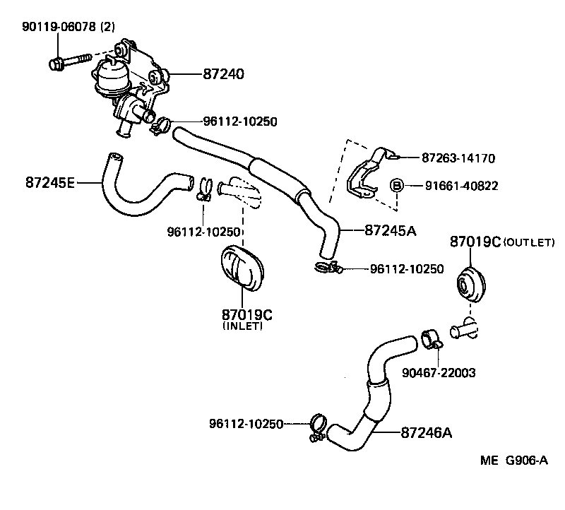

Sounds like your heater valve is stuck closed. It's a common problem. Here's a diagram of it, located on the passenger side of the car on the firewall:
You can see the feed to the valve, and the outlet of the valve going to the core. If you look closer:
You can see there's a plunger on the underside of this valve, and a vacuum line on the top. First, make sure you have a good vacuum supply to the top of the valve. If you don't, fix that and your heat will likely work again. If the valve does not open (plunger should go UP w/ vacuum applied), then do this:
See the arrow under the valve pointing to the plunger? It'll require some force, but lift it up, and use zip ties, or a piece of bailing wire to hold it in the up position. This will allow heated coolant to circulate through the heatercore, thus giving you heat. :)
