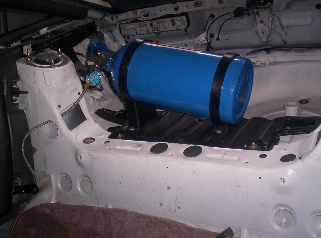

This is how i did mine
it got alot of Attention though, i would park and people would walk by and be like OMG(*@$(*(@$*)@$ Thats Nos, holy shI1491490 its kinda gay, but THing with Nitrous is. it holds its Value... u can keep it and put it on any car you want to. so u can sell or hold on to it.
